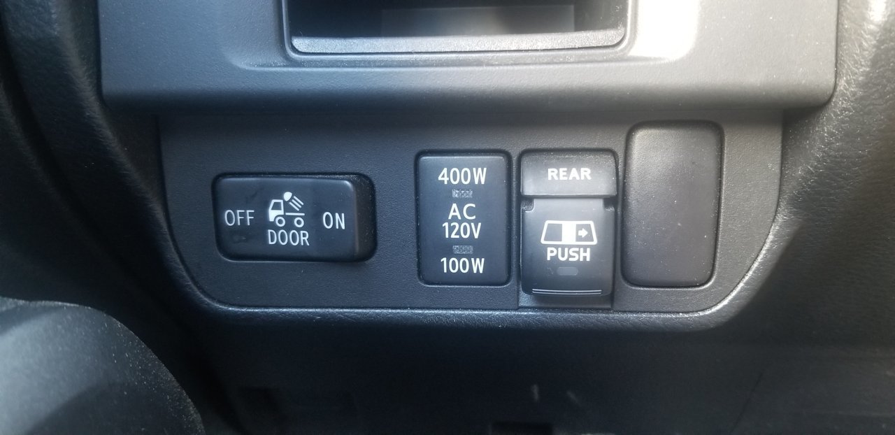

    What does your left cubby switch panel section look like?
    Figured if it were viable down the road, we could swap switch panels from the left side...just a random thought that just popped into my head.

    I have the 'cargo' light switch, rear outlet power, and auto dim; 1 horizontal, and 2 traditional vertical switches.

    here's my setup, though I don't believe I have an auto dim feature ony 2017...

    I realized I omitted the blank I have - mine is the same, but replace window switch with auto-dimm (idiot mode) and swap left to right. I'll have ot rip the dash apart sometime...not looking forward to that.
