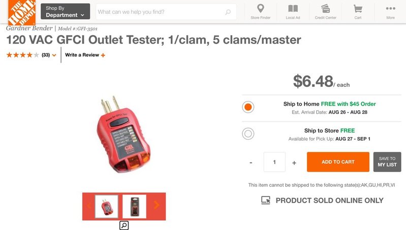

    I briefly read through some of the posts but lost interest in the code squabble. As mentioned check to see if there is power at the outlet and/or a GFCI has been tripped. To do this start with one of these. Just plug it in and read the lights on it. Cheap and available at Home Depot and just about everywhere else. Has instructions and a little table printed right on it.
    http://t.homedepot.com/p/Gardner-Be...ster-1-clam-5-clams-master-GFI-3501/202867890
    Plug it into an outlet. No lights? Move on to the next one... If a GFCI has been tripped it will tell you, if there is no power at all, it will tell you.
