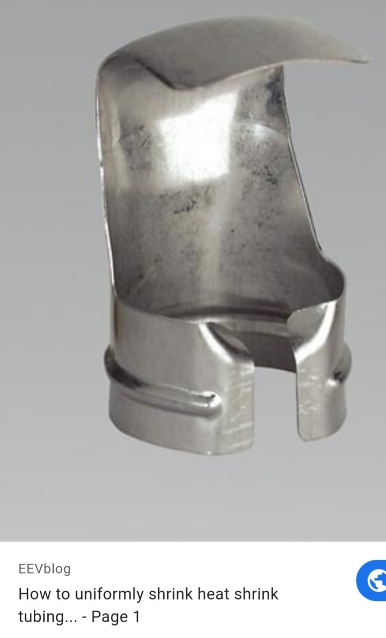

    It completely depends on the application on what is best for the job. I used a Blazer torch (similar to picture)
    when I was on the road installing new trailer lights and harnesses. I used water resistant connectors that had solder rings inside and a thick heat shrink with glue inside. Since the topic is heat shrink this isn't the best tool for the job in my opinion. The heat is too hot and too focused. This type of torch is also very good at soldering large wires/cables together.
    With my Weller portosal I can shrink heat shrink quite well. I can also solder wires with it. I can weld plastic with it. I can build intricate plastic parts with it. A friend of mine window tinted a pickup with one.
    Someone earlier posted this
    which is similar to a Weller and it comes with the heat shrink attachment which a Weller does not. Heat shrink attachments are available in several different sizes.
    I've used a heat gun a lot. Hundreds and possibly thousands of hours. Makita makes the most longest lasting corded heat gun. Milwaukee heat guns are good but heavy. If a person is going to do heat shrink all day long a heat gun is the way to go.
