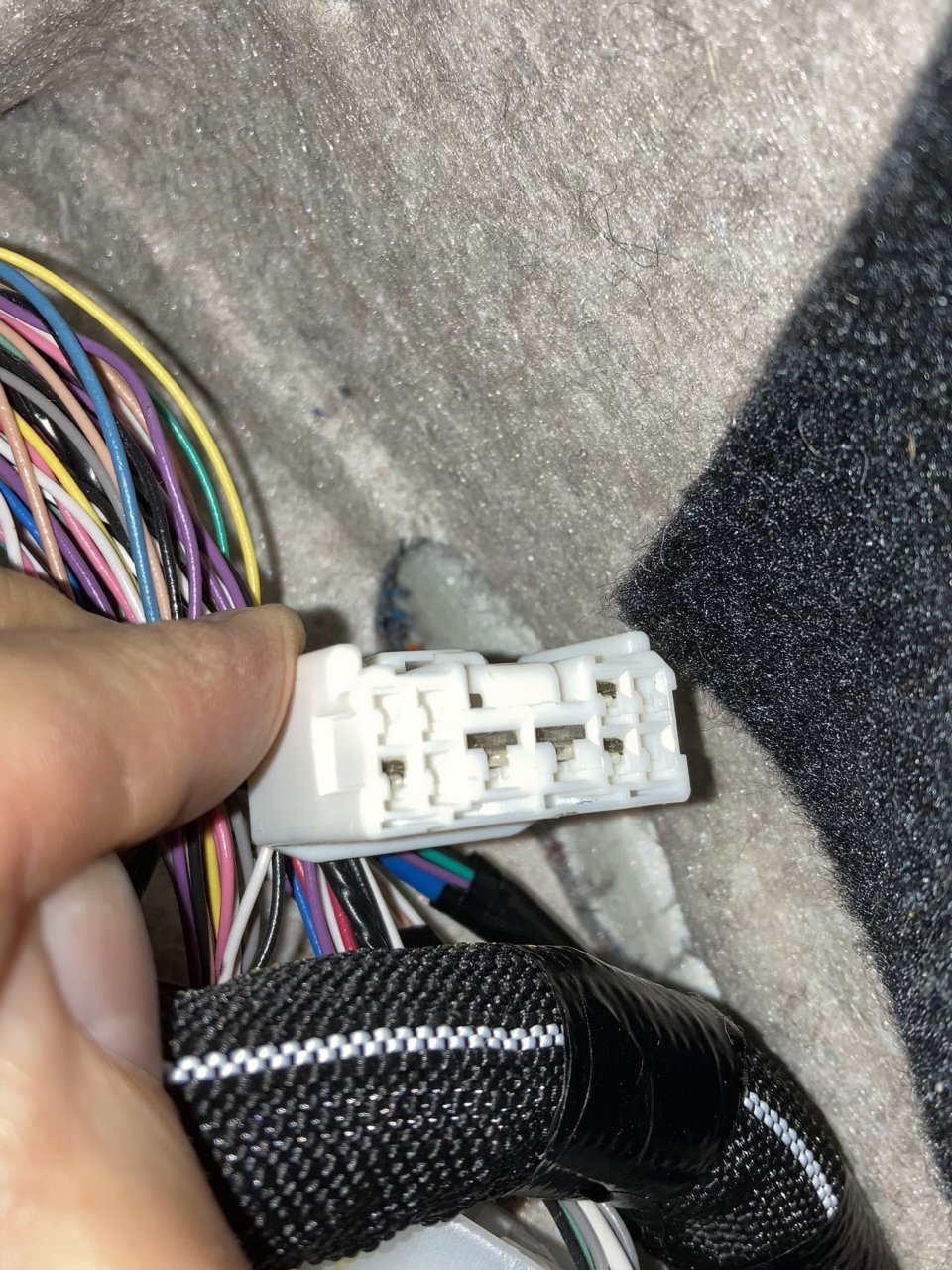

    The popular model brake controllers have a wiring harness that plugs into the Tacoma connector located under the driver kick panel. The connector may not be obvious at first look but if you search around you’ll find it, behind a wire loom close to the firewall. Looks like this:

    Thanks. I found the plug. The video I watched seemed much more involved but it was also mounting the unit. I was hoping I could plug it in and Velcro it somewhere.
