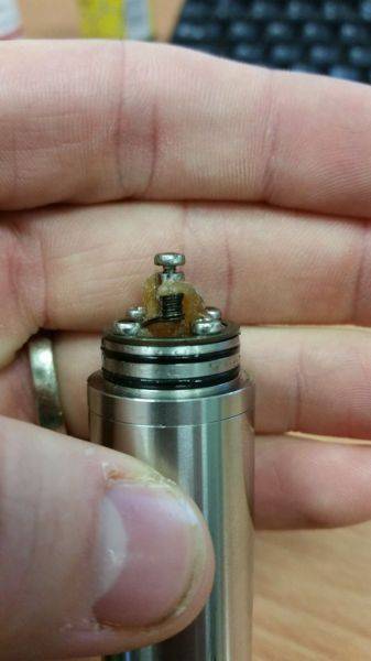

    She's a little dirty and probably needs a new wick too.

    is the wick going through the coil or just jam next to it?

    It's through the coil. It's not the prettiest build, nor does it chuck a lot of vapor, but the flavor is phenominal.

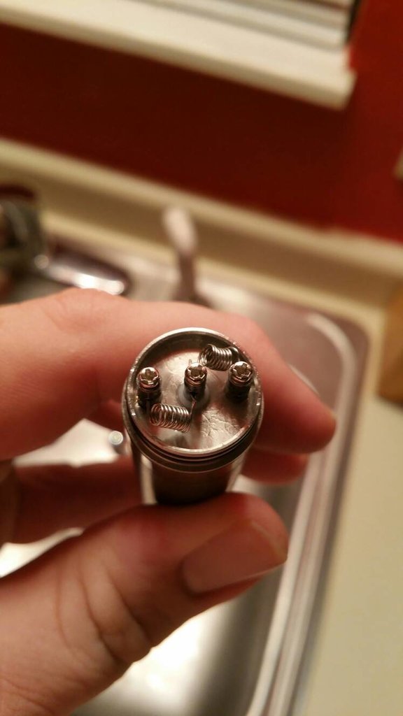

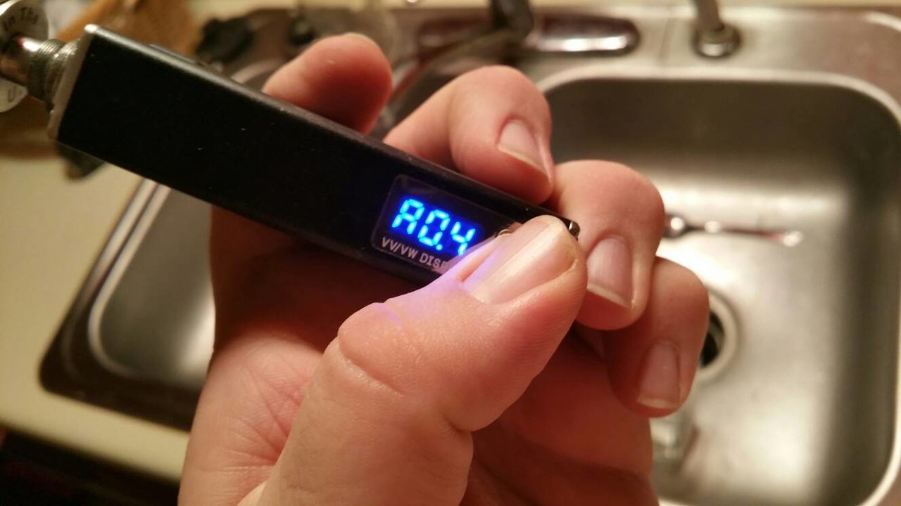

    Well definitely not pretty but I made my first coil tonight .4 ohms starting out and by the time it was ready to hit .5

    Patriot rda nemesis clone mod with a Sony 30a battery. The hardest part for me is getting the coils to glow quickly and from inside out. Also used 26g kanthenal wire (vape shop had that or 30)

    It helps to heat the coil up to hot red, release the trigger and squeeze the coil tight with tweezers.
    and the distance of the wire from the the coil to the pos and neg need to be pretty identical on both coils.

    Gotcha. I plan on rebuilding in the morning or Saturday on a fresher battery. ( I have been messing with it on the stock .6 ohm patriot coils.

    Is there a reason you made them angled vice parallel to the deck?

    Just the way they came out for some reason. Also the coils that came on the Patriot were angled as well
