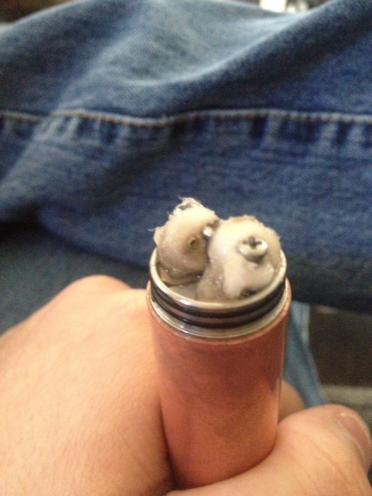

    Being turned up like that is called dragon coils, you wrap the cotton around the coil not through and then drip in and around the coil.

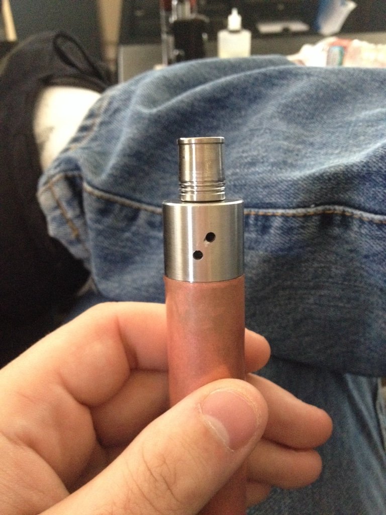

    Did a new build, dual 5 wrap parallel 26g reads at .16 and also drilled out the air holes on the cap and then drilled out the wide bore tip to get a bit more air at the stem 5cefc19b51d600da6728af62ba49295c_42fcf9c8a52214e9c5cf59b19b099d61b303fc56.jpg

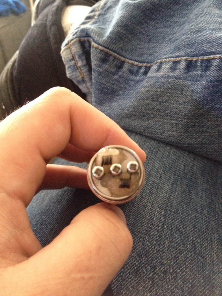

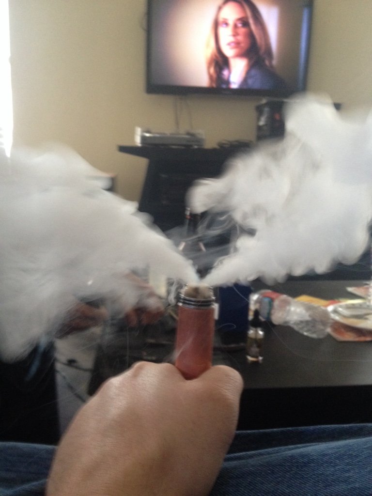

    New build lol dual dragon coils on 24g 8 wraps
    933dce2aa14654a509b169a44db8304b_301a9e17dad8cd56a82f77dfc9547e8b4e612125.jpg7189583107c6d0d13d84acb307ddca93_14a014f8381a87566f3c7e0b67dd6982fd1d67b5.jpg

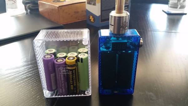

    Next on the build docket is an 8 x 18650 unregulated box with dual 28mm 510 connectors. Yes, dual 510's. I was going to do 2 fire buttons, but I found I have more space and less wiring if I do just one fire button but a switch so I can choose which 510/tank to fire. Totally an around-the-house or a camping vape setup. 8 Panasonic 3400mah batteries means just over 27,000mah of total power. Rechargeable and with built-in voltmeter of course.
    I already have the clear box, and the 8 batteries fit perfect. Just waiting for the buttons and 510's to arrive, plus the battery terminal springs, and I'm ready to build.

    Holy crap dude!
    Why don't you just skip ahead to the flux capacitor already and quit screwing around? :D

    Holy tits! This is gonna be intense.

    I can't wait. Parts are coming in every day now, so all I'm waiting for are the buttons and the voltmeter. The box for this is slightly wider than the circuit boards I use for battery supports, so I'll have to re-engineer that a bit with some cut acrylic sheet. The cardslots in these project boxes are spaced just where I need them, and they worked fantastic in the dual 26650 mod.
    I should have everything delivered within the next week, and I'll probably have it built within 2 weeks as I find time.

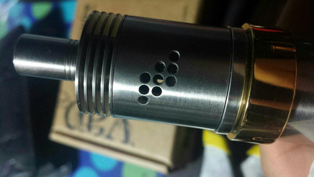

    What you know bout air flow :cool:047e99ada332dcb6cb61fd6b957b0542_3a37e762f4fb94f03af7e46d408bd89ed1430b01.jpg

    You need to get a chuck Enuff tip for that!

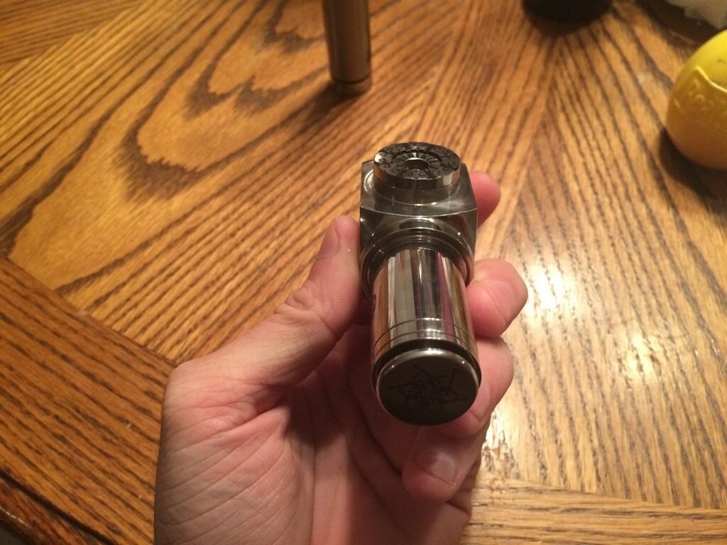

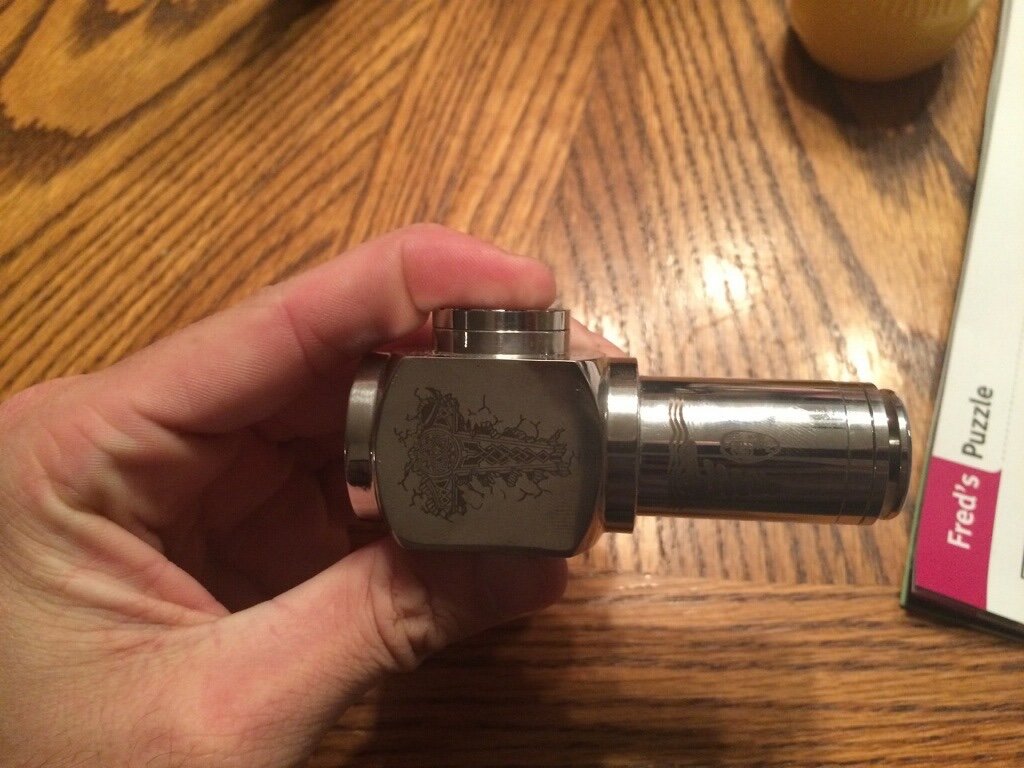

    I have a buddy who wants to sell me this mod (the hammer) and I told him I vape to not smoke and dip not quit smoking crack. I'm not sure who comes up with a design like that but they need help lol

    A good friend of mine got one of these for his collection, and he ended up not liking it's weight and shape. He said it was a pain to use when driving because it didn't fit in a cup holder very easily, and he said the shape was too crack-pipish and just wasn't worth it for the price. Proceed with caution unless your friend is giving you a ridiculously good price and you just want it for your collection. I don't know anyone who has bought one that still uses it.

    I have no want for it, he said he would sell it for 30 but that still doesn't appeal to me. I'm thinking a dual 26650 box mod
