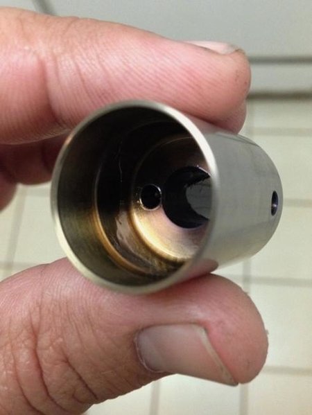

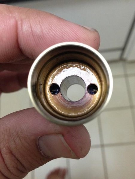

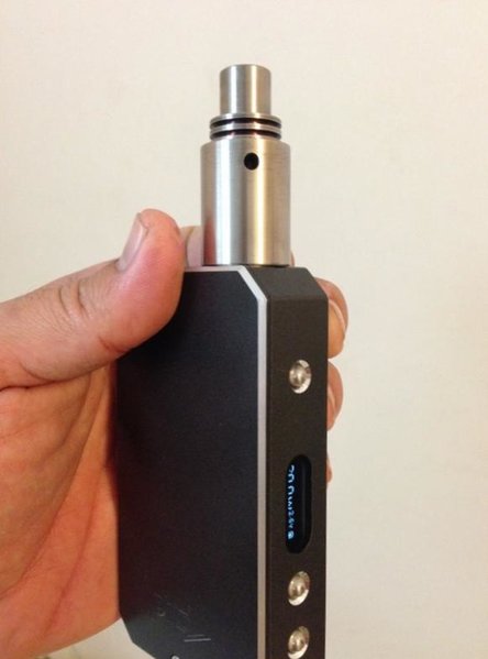

    I have been using this setup for a week now, and am really happy with it. I've been wanting to try and make a cap like this for awhile actually. Its a one piece titanium drip cap with a 5/16" bore. The air holes are very high because they are ducted. They go in 1/4", then intersects with two vertical holes so they blow right on top of the coils. Very little space between the cap and the screws. The purpose is to eliminate leaks and hot juice popping out of the air holes. I have not had a single drop of juice leak from this thing yet. It also vapes very nice. All the air holes are 1/8". I flamed colored the Ti once, but polished it off. I'll polish and flame again later. The inside and down in the cooling fins still has some color. Its on a plume veil atty.

    What atty is that?

    Jeez... Did I type all that for nothing? :D
    Let me summarize. It's a plume veil atty with a one piece cap I made :pout:

    I didn't see the whole plumeviel part. Mostly because I was still half asleep when I read it.
    Should make me one :spy:
