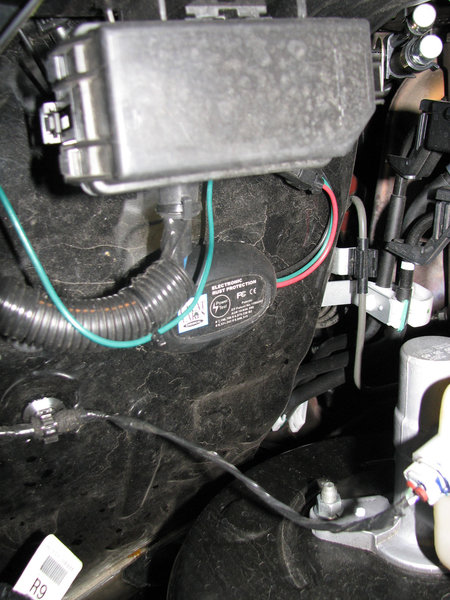

    george3, I'll snap a pic, but it's just something attached to the battery, and grounded to the truck so (supposedly) an very small electric current to the truck keeps rust away ....

    here's the one that came on my truck.
    my apoligies to the OP if that is NOT what you were talking about ...
