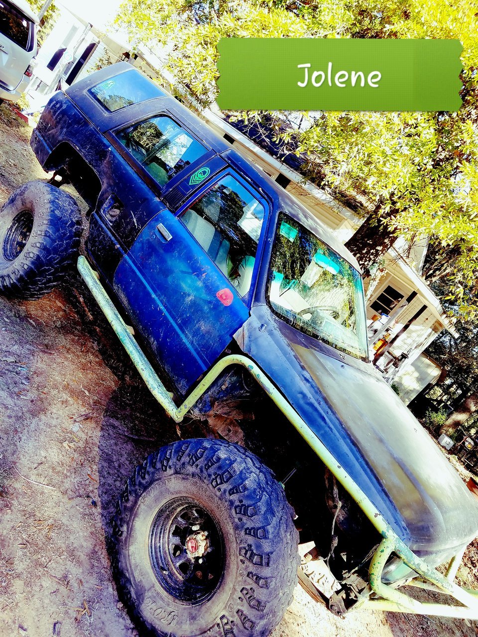

    I've been infested by them for a while..lol I just can't afford to make the 03 taco like I want it AND the 88 sas'd 4 runner...which really only needs new 37" tires...and a winch....can't properly send it without a winch..lol oh, and finish the exo cage out all the way around the rig...20171116_111139.jpg
