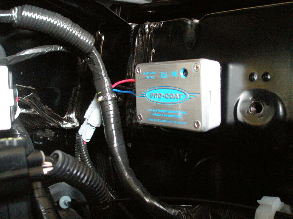

    I have the same type of "electronic rust protection" on my Tacoma too, except my unit was made by Pro Coat. The dealership offered it to me when it was new and they installed it for me. If I remember correctly, they charged me around $400 for the parts and labor. I did not want to do traditional undercoating since it can trap/hide moisture, cause it to rust under the undercoating, etc. At least this way, I'll be able to see the areas where it's rusting and periodically crawl under there and properly treat it and touch the area up. So far though, not much rust since I brought it home, though it's probably too early to gauge its effectiveness.
    I'm supposed to bring it in yearly for a free checkup, where they inspect the unit and change the anode or something (I forget if that was what it was called). I guess I'll be the long-run guinea pig for you guys. :D
    A pic of the unit installed in my engine compartment:
