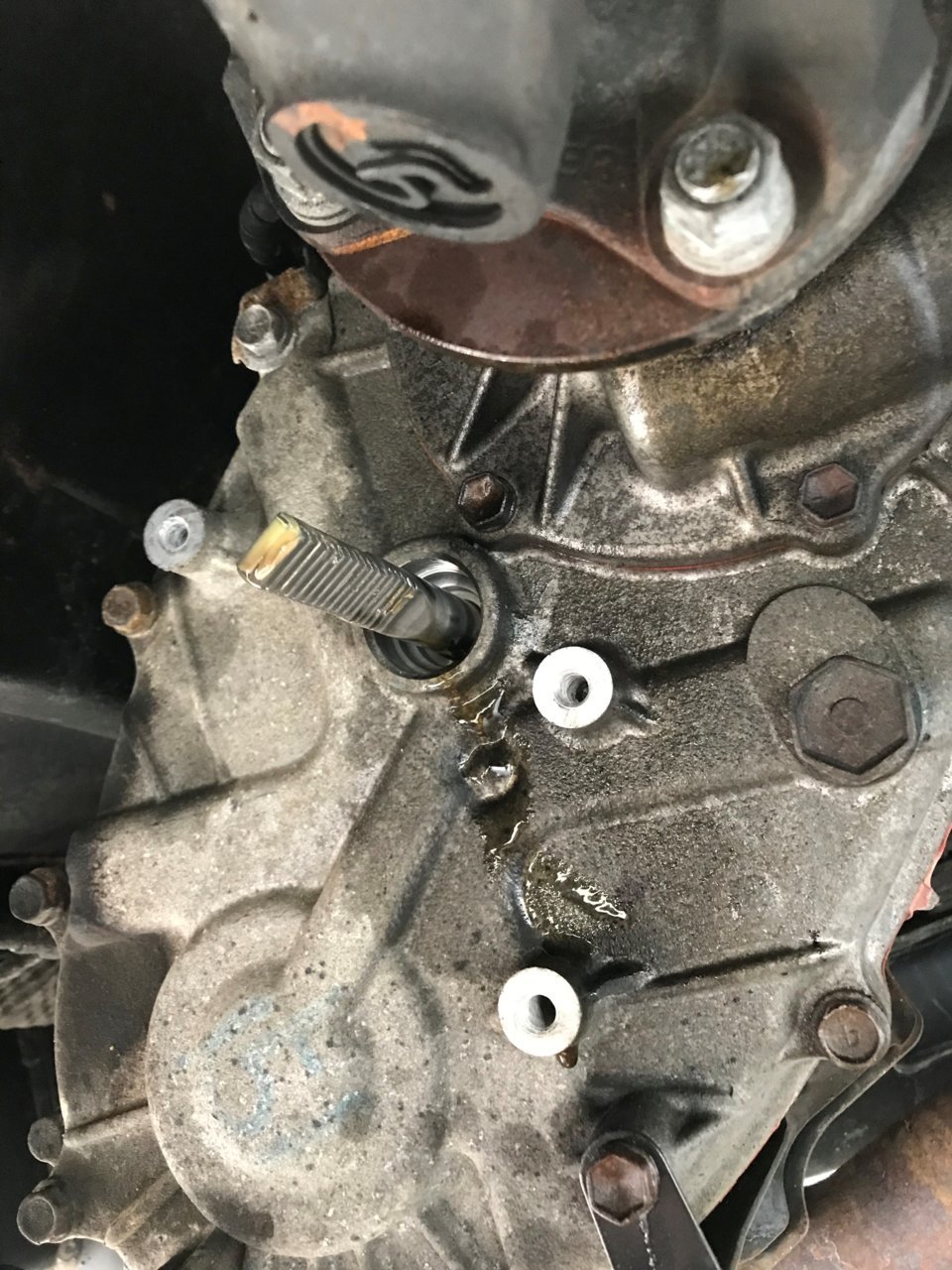

    Has anybody converted the electronic 4WD system to a manual system in 2nd gen tacos? I had a few previous posts about troubleshooting the electronic 4WD system, but went a different route and have decided to somehow make the tcase manually operated. I pulled the front ADD off and locked my front axle so all I will have to do is get into 4WD from the tcase. I pulled the tcase actuator off over the weekend exposing just the shift shaft. Just by operating this shift shaft (since my front axle is locked) I am able to get into 4WD. Now just got to rig up a linkage system or buy something. Anyone got any ideas or can refer me to a custom website?

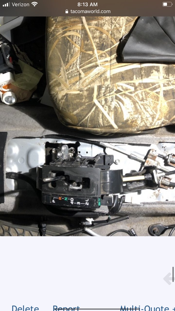

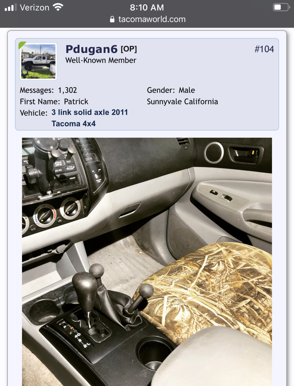

  12. Feb 15, 2021 at 8:11 AM
    Pdugan6
    Pdugan6 Well-Known Member
    Aug 11, 2013
    #110271
    1,489
    Patrick
    Sunnyvale California
    3 link solid axle 2011 Tacoma 4x4
  13. Feb 15, 2021 at 8:14 AM
    Pdugan6
    Aug 11, 2013
    #110271
    1,489
    Patrick
    Check my build thread you’ll probably find something useful.
    WIL838[OP] likes this.

    Thanks for the build thread Pdugan6 I will check it out. 6GearT444E I want my shifter to come through the coin slot, but not sure if the j shift pattern on the stock shifter needs more room. I will look and see when I take the case off, get the new one and see where it lines up first.
    So without considering desired shifter placement, where would the shifter protrude up if you didn’t do any welding mods? In other words, where is the actual location the manual shifter comes up through the cab if you straight up bolted the t case on? Because this stock location might be good enough for me. I don’t know anyone who welds and would prefer to knock this job out on my own.
