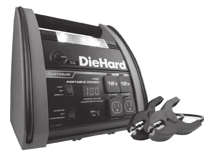

    Model 28.71988
    Seen here:
    http://powertool.manualsonline.com/manuals/mfg/sears/2871988.html
    Photo Below.
    I neglected to charge this item every month, as instructions state, and so the battery no longer took or held a charge, at all.
    I bought a replacement of good quality and matching the required 22 mah (EDIT: S/B 22 Amp Hours).
    After charging the 36 hours after installing, I get an error not listed in the manual.
    A few seconds after I turn on the "Inverter" I get a high pitched alarm and the display shows "OL". I assume overload.
    Instructions state to connect device, turn on the inverter switch, then the device.
    If error "ERRRR" shows quickly switch inverter switch off/on.
    I did that.
    I have turned it on without and with a device attached.
    I have turned it on, with device attached, and then turned on the device.
    No change. The replacement battery company is willing to replace the battery, but I told them I would rather know it is the battery first. They asked me to take it for a 'Load Test' and email them the result.
    Great customer support from Mighty Max.
    Is there anything else I can do.... before I throw it out if the battery I bought is good????
    I would like the inverter to work.
    Thanks,
    Ken in NC

    Is there a way you could temporarily jump another battery in place of the one inside? If it is a 12v battery, you could try it with your truck. I assume the 22mah spec you refer to is a misprint.

    This being Sears the device is not seeing your aftermarket battery no doubt looking for something the replacement battery does not have .
    I ran into things like this from Sears over the years
    Is the battery no longer available from Sears ??

    Update:
    I donated the one above. Waste of money and time to me.
    I still have another one I had bought later. It started to 'Not hold a charge'.
    The manual says to charge every 30 days.
    I brought into the house and put it on to charge. It immediately said 100% and indicated charging.
    The next day, when i took it off the charge, it immediately went to 98% and then lower as time passed.
    For the next week or more I would put it on for a charge at least 8-10 hours. Then check it.
    The next couple times it seemed to hold charge longer.
    I kept cycling the charge 8-10 hours and then letting it set.
    I have had it set after charging. This is the 3rd day, after the last charge, and it still shows 100%.
    I wish I had tried that on the one above, and the ones I had before also.
