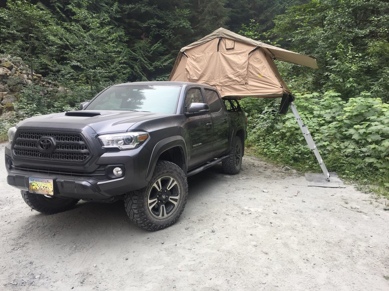

    That was the first thought I had as well but here are the big reasons it doesn’t work
    1. Dog + baby in the pretty near future = no roof tent
    2. They are pretty damn expensive / hard to justify when I already own two really nice tents.
    3. A good friend reminded me these are all over town (Slc, UT) and yet they never come off. We all get lazy in the summer and don’t ever take it off so we end up loosing another few miles per gallon in an already losing battle.

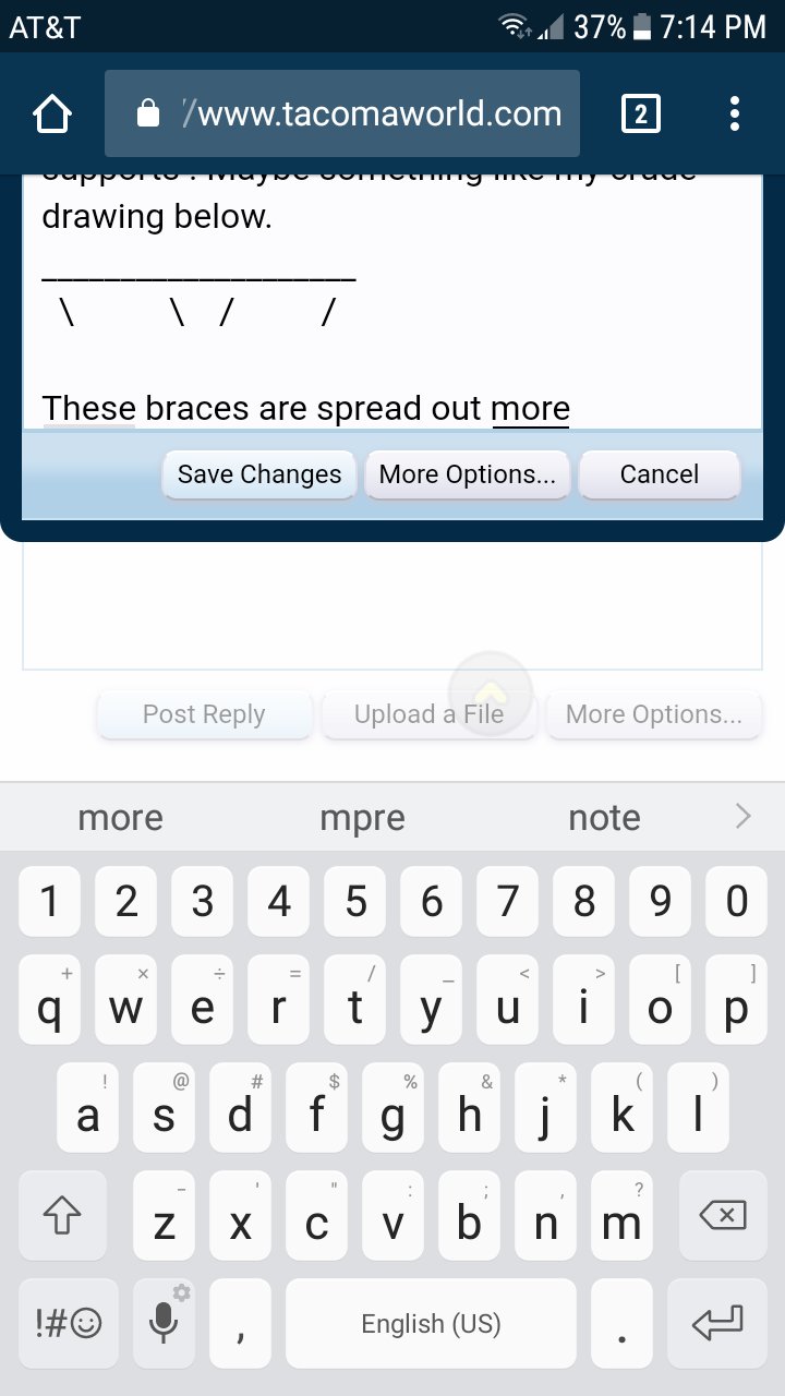

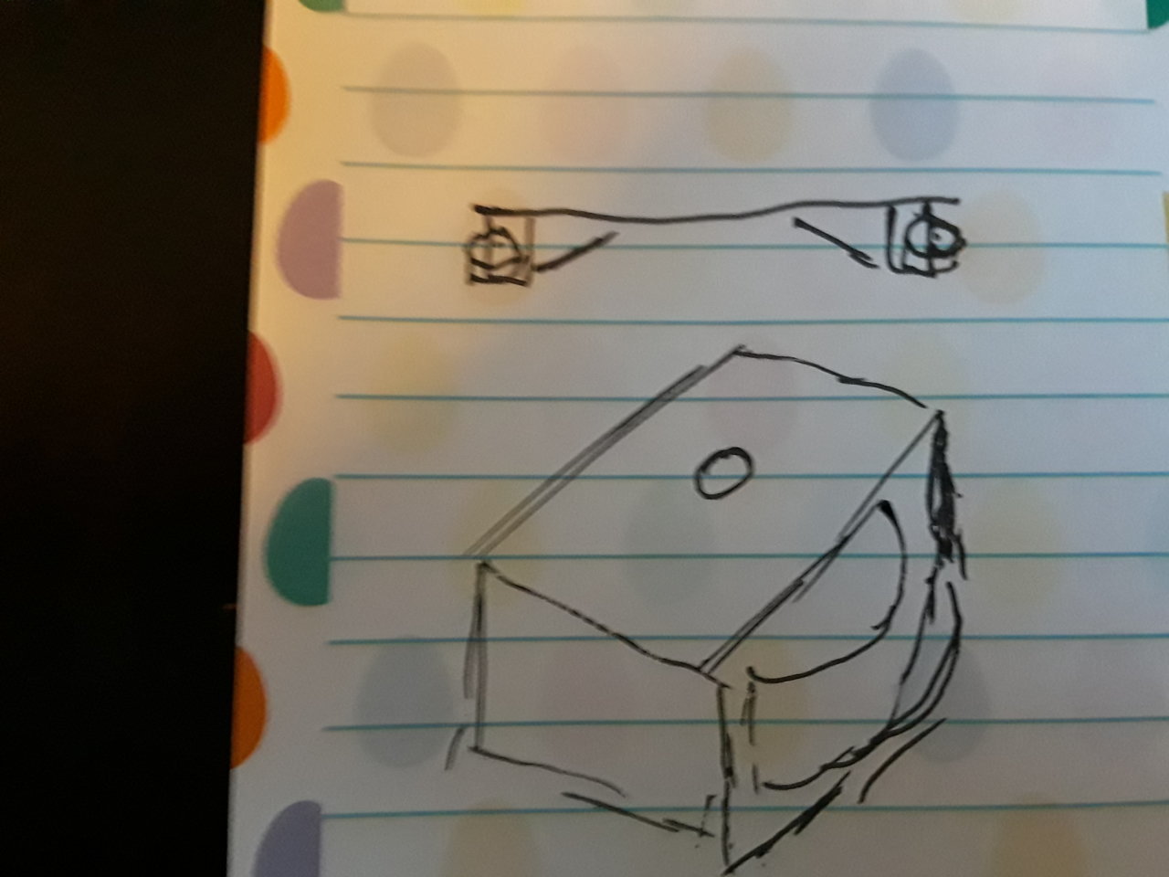

    They are still mounted into the composite bed (basically strong plastic) and being at the top it loses most of its strength. As I see it the load would need to be distributed evenly.. and reinforced with some angle supports . Maybe something like my crude drawing below.
    ____________________
    These braces are spread out more
    Edit, now you have me thinking. If it was a piece of round tube with flat ends so they rest on top of the bed rail and mount a metal box with wheel inside. I made another crude drawing.

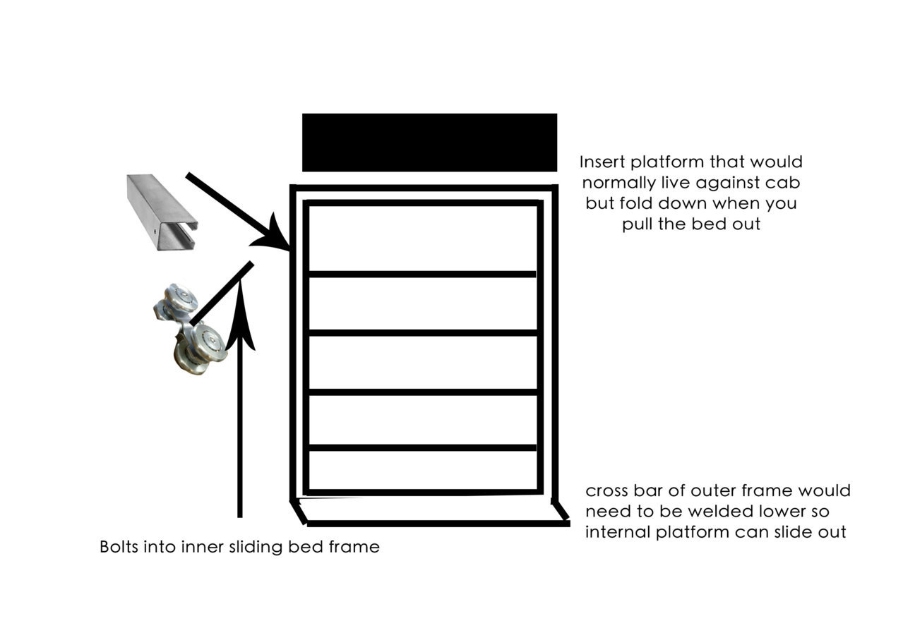

    @JaCado i like the rail idea especially because I have a bunch of speed rail fitting laying around from film world. Kind of like pvc fittings but made out of aluminum. The other rout I have been thinking is removing the existing side rails and bolting in a square frame to prevent the sides from tacoing inward. You could then use the square frame as the side rails with casters inside the rail. Need to break out the sketchbook as well to paint a clearer picture

    Another reason this system would be so cool is because when you want to use the full truck bed interior you can just slide the full bed platform out of the tracks and store it.

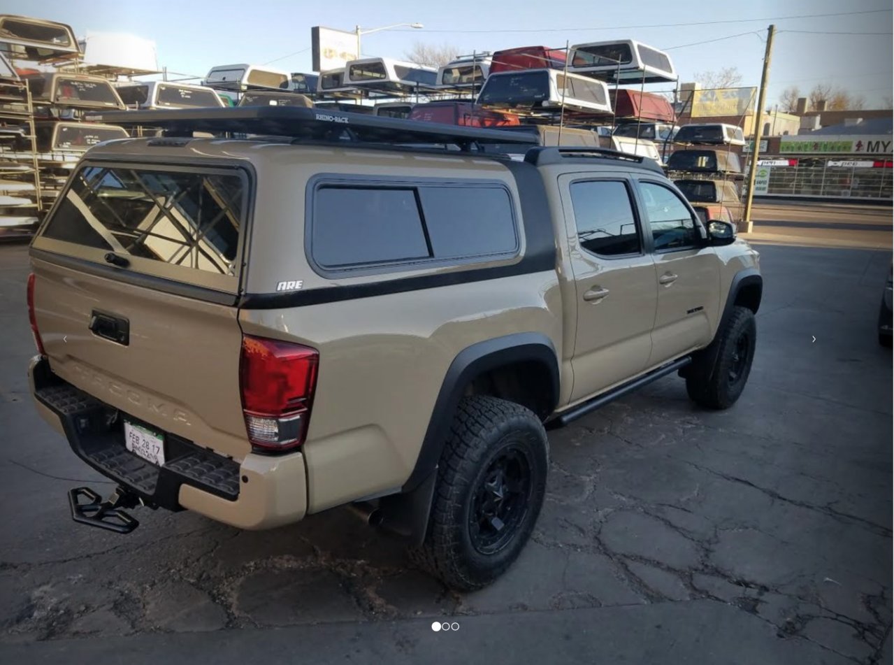

    I dig those a lot but they are beyond my price point. Not to mention my Overland Shell gets here next week. I also have a deal with Rhino for 75% off so I would like to through one of their racks on top of the shell for additional storage. This is basically what I am working with but in cement gray.
