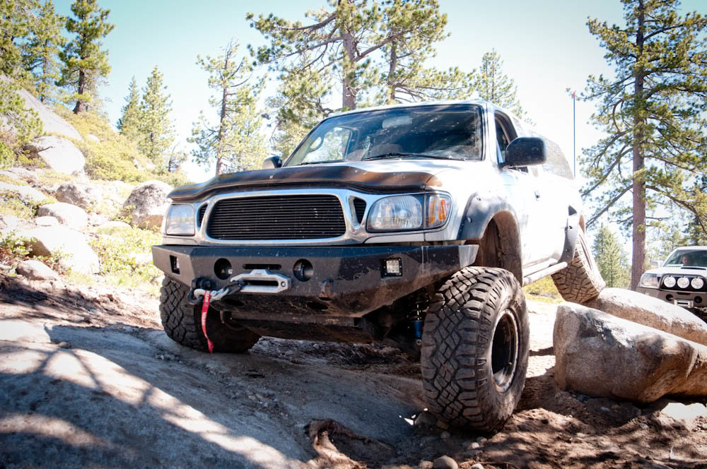

    Pretty sure Jerry is running 2.5x8s on his stock buckest and LCAs..

    There would be virtually no up travel with a setup like that. Most people who have mid-travel have OEM Replacements or a modified generic 6" C/O with a specific top plate for the vehicle.

    How would there be no up travel? with new UCAs wouldn't you be fine?

    Seems to have plently of uptravel with extended travel Foxs. and he has TONS of droop.

    No, because there is very limitied uptravel on a stock setup & with an 8" C/O the compressed length would be 2" longer (approximately) then a reg. replacement C/O limiting the uptravel by 2"
    UCA aren't usually for travel they are typically to correct wheel alignment which is asqued by lifts.
    An Extended travel C/O is not a 8" C/O it's really a 6" Coilover. That falls under the category of OEM replacement C/O's
