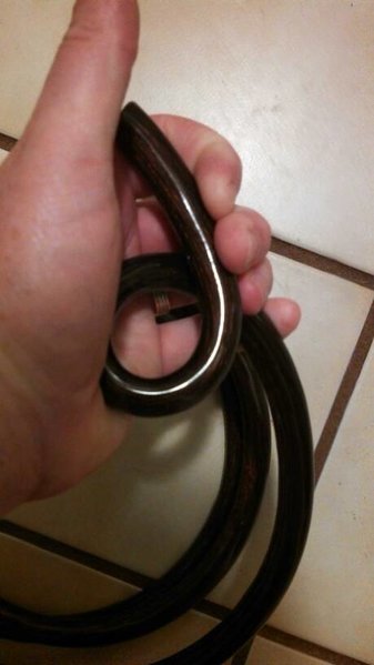

    So the reason I used 1/0 wire is because it is about 1/4 or less cost wise than 2 gauge. 2 gauge is considered "Battery cable" so it is more expensive. I extended my solenoid with 3 six foot runs for less than $50. That included cable, terminals, heat shrink, and a hammer crimper.
    Now, yes 1/0 wire is not as flexible but I had no issues. And I'll be able to recoup some of the money reselling the crimper and extra 7 feet of wire I have left.
    Post up what you pay for the 2 gauge :beer:

    I am sure you are correct about the 1 aught wire concerning costs. The inflexibility of the larger wire was one of the reasons It was recommended for me not to use it. I have not tried a welding shop yet for the flexible,larger gauge stuff, which is my next stop. According to the electrician I spoke with, the 1 aught stuff from places like home dept is for homes and other permanent, non moving applications.
    There is a reason cars use flexible, multi-strand wire. I am not saying you are not, but for folks who don't know, like I was, it probably should be noted.

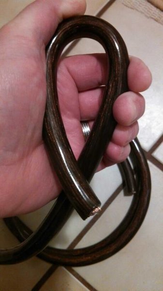

    1/0 is used in car stereo wiring for multiple amps. And is very flexible. Here is a picture.
    Just trying to help y'all save some cash. But I'll leave it alone.

    I was only educating. No disrespect intended, or needed it looks like. I just wanted to clarify the fact that all 1 aught wire is not the same.
    Wire used on a car is supposed to be flexy, to eliminate fatigue, and a short that can cause a melt down.
