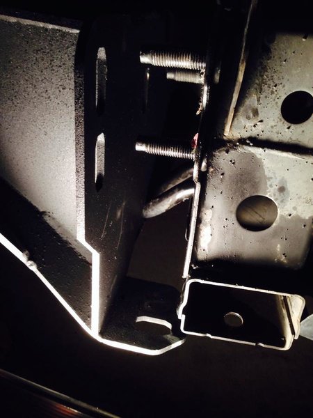

    Hey guys I have a question. I tried installing my bumper last night but I have this loop that is welded on that keeps it from being bolted on. Looks like it's a tow loop.

    yeah - you have to cut that off.

    angle grinder & 30 seconds... No big deal really - just make sure to paint the raw steel to prevent rust. :thumbsup:

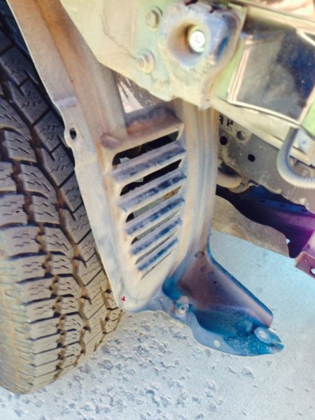

    Ok and what do you guys do with the plastic that hangs down

    More cutting haha unless you want to take the whole fender well out.

    Cut cut cut cut it all. I have no liners haha
