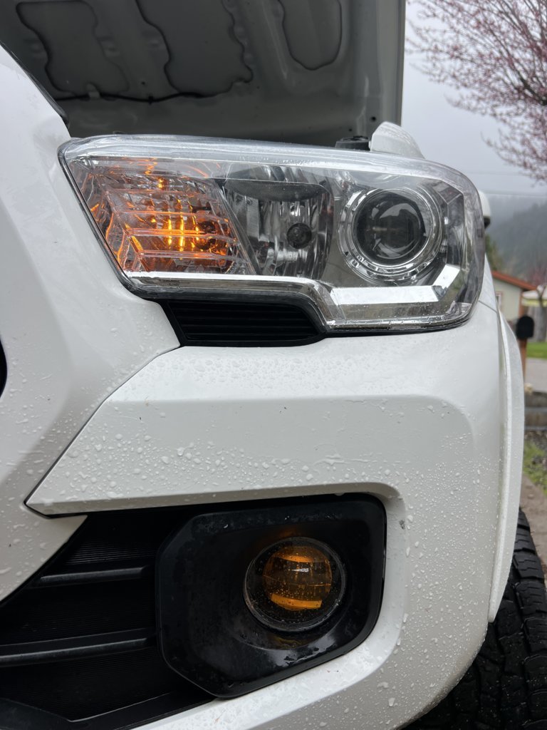

    I definitely suggest not buying these for the backlight feature during the day. It's eh...I didn't buy them for that though. I bought them for cost savings and from @crashnburn80 's suggestion on best bang for your buck to match the Halogens color. I ordered the plug n play harness but it didn't work for my 2023 SR5 DCLB. I think it's for LED headlights? Here is a pic of the backlights on with the DRL's. I think Diode needs to be more specific on the site about which models the harness works for.

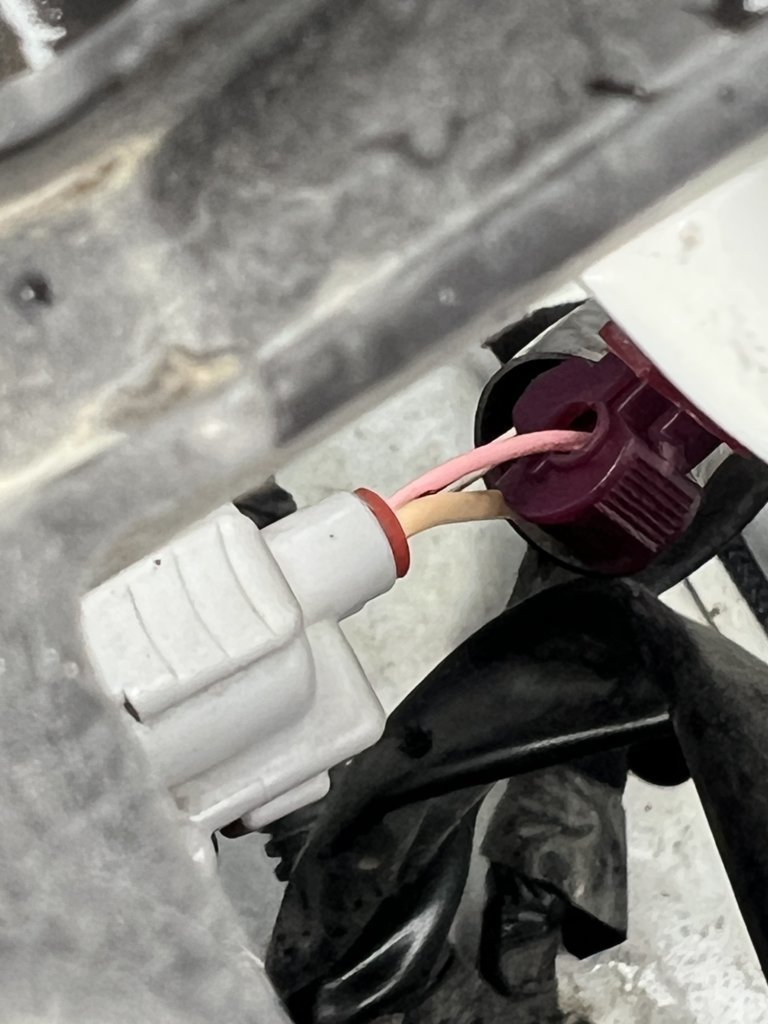

    Found that I had to tap the middle wire on the driver and passenger DRL's to match the backlight feature with the DRL's. It was the pink wire on the drivers side, and dark blue on the passenger side. Google searched how to use a wire tester to find the hot wire. Science! So if you have a SR5 like me, hopefully this helps you.

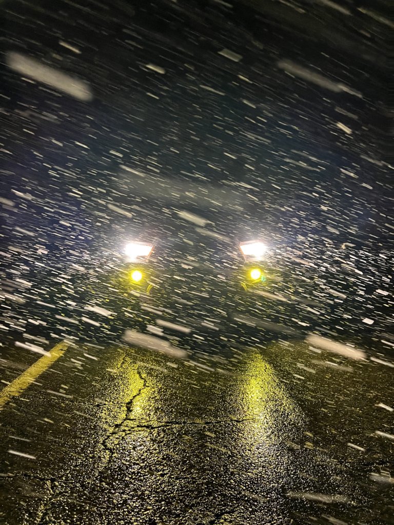

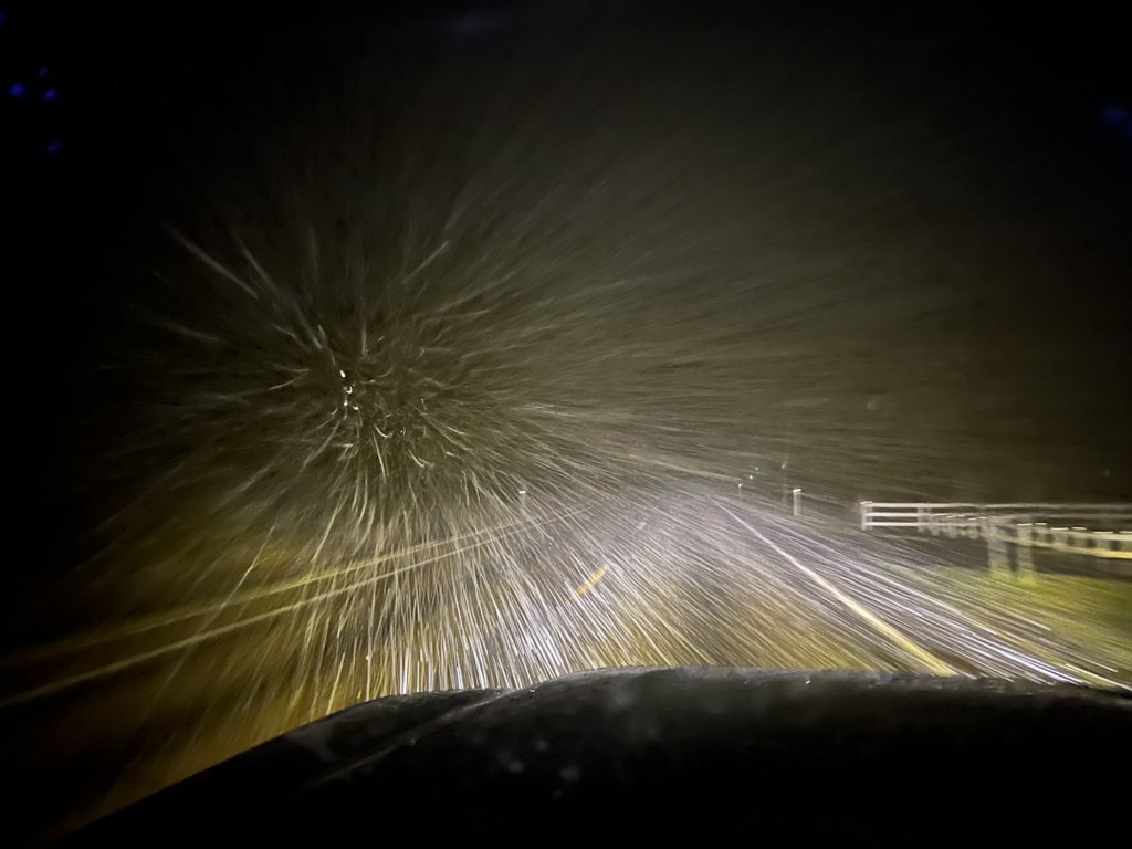

    Just so happens it snowed like hell in April and I was able to test them the same night I put them on. I was actually expecting them to be a bit brighter but I think I got what I paid for. They look great and definitely help to see in gnarly weather and are a significant upgrade over stocks. One day in the future when I hit the lottery, I'll spend over $400 on small little yellow lights.

    Thanks for sharing your thoughts! Our signature backlight feature is designed as an accent light rather than a daytime running light, so its visibility is more pronounced after dark, especially in the SS3 or Elite Series fog lamps.

    You can simply locate the 12v DRL lead from your headlights to tap. That's the most popular option to signal the backlight.
