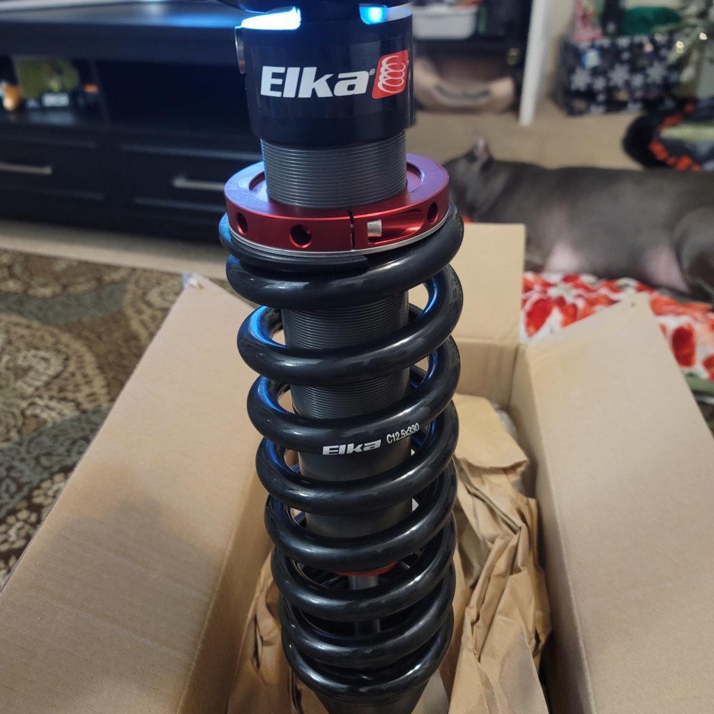

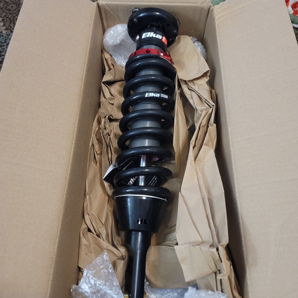

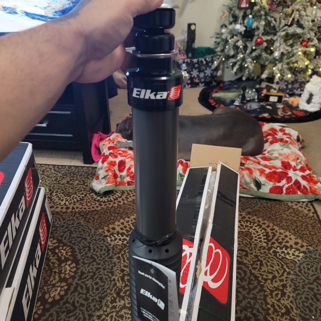

    Christmas came 1 day early today theze are NICE
    They are Elka 2.5 IFP 2-3 inch lift present from the factory at 2.5 inches.
    Went with Elka cause they are an all aluminum body. Plus they been in the game for a long time...

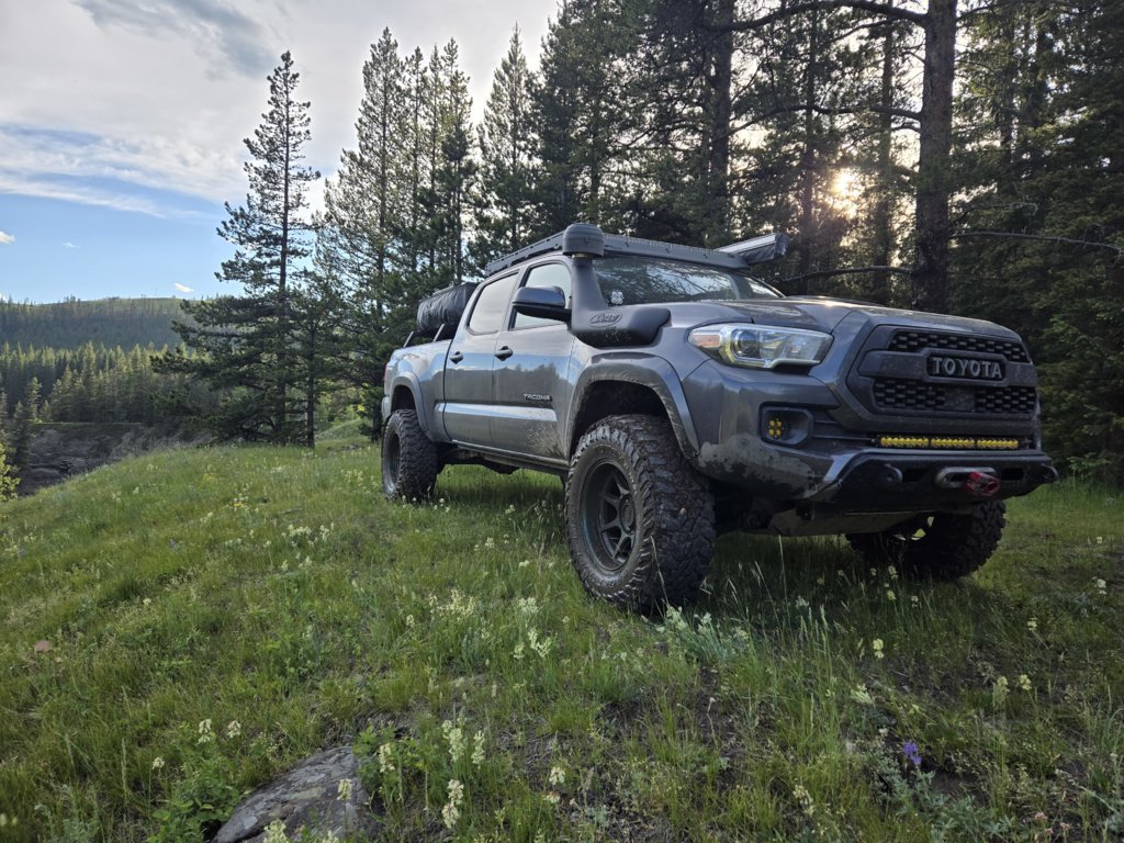

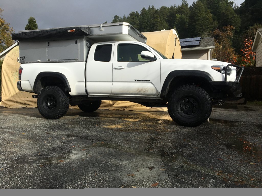

    I have a front bumper from Backwoods..."Hi-Lite Overland". It has a steel cradle for the winch and aluminum bumper...I'm running a Comeup 9.5S winch. The Elkas work a treat. The rears mate well with my Deaver stage 3 leaf springs.
    I don't have any up close photos, but I have a recent shot when I slapped some Method 701's wrapped with 255/85/16 S/T Maxx (the rear is unladen in the photo, so it's sitting a bit high...when fully laden, it sits nice and level).

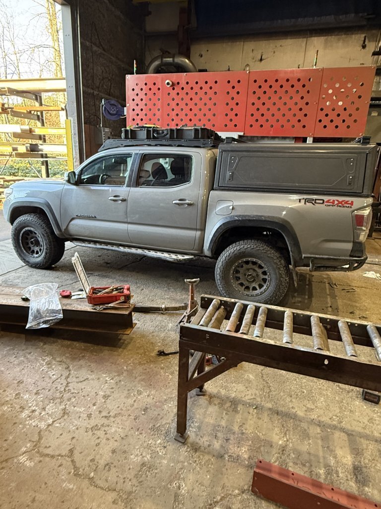

    This stage 1 deavers, I think 3/8 threads showing on the 650lb eibach and 285/75r17. Nothing under the Alucab.

    Interesting experience...
    The Elka 2.5 (non-resi.) came with 7/16'' of thread visible above the adjustment collar, and no additional adjust was needed when I installed my winch and bumper. It carries the weight very well. The ride is excellent in my opinion!
    Cheers

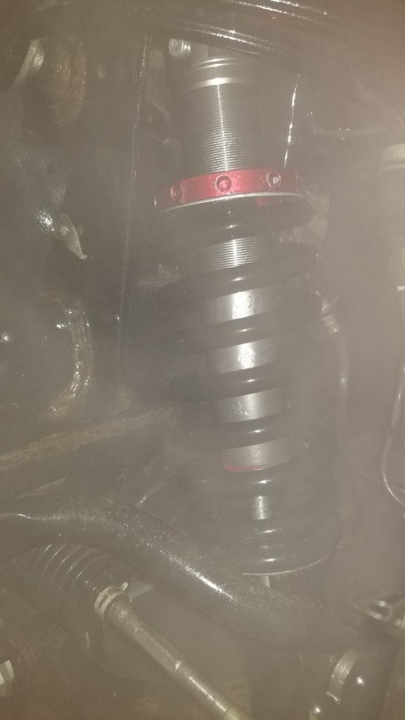

  15. Dec 28, 2024 at 9:40 AM
    Inyo_man
    Inyo_man Don't piss down my back and tell me it's raining.
    Nov 18, 2023
    #437748
    166
    U.S.A.
    2023 Tacoma TRD, off-road, access cab
    JBA Offroad, High-caster upper control arms (made in the USA) installed at the same time as the suspension.
    Alignment went very smoothly... 0 degrees on toe and camber, and about 3.5 degrees of caster.
    Cheers
    TRD_dee151[OP] likes this.

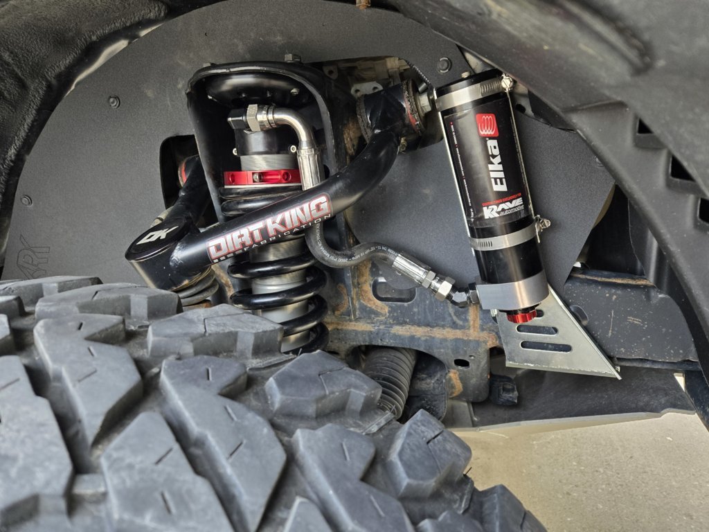

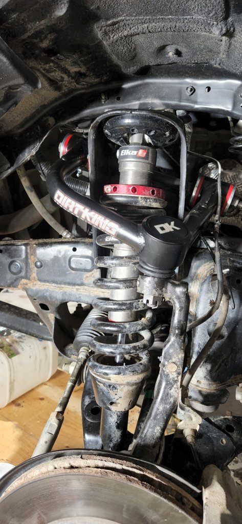

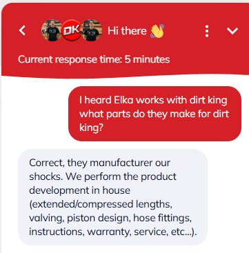

    Just thought Ill share this for the people that have Dirt king suspension, Elka also makes shocks for Toytec......
