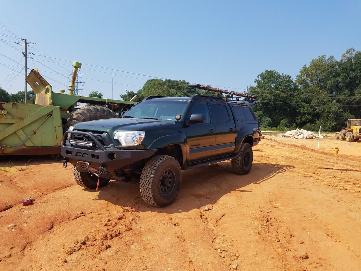

    I'm in the same boat looking at coilovers, ready to replace my OME. Not to derail but wanted to piggyback as the topic is already here. Setup includes steel front bumper, full bamf skids, sliders, lca skids, rear hc bumper with swingout, leer cap, not sure total weight but my OMEs are wearing me out and near 60k on them. I'd like to replace both front and rear coilovers, running Dakar HDs and those still seem to be in good shape so I'd like to keep them on unless there's much better options to jump to while upgrading. Most of my driving is on road with some offroad on undeveloped sites or forest service roads, but our roads basically ride like a washboard road anyways so I figure if I'm replacing I should be happy. I can't seem to hit a pothole or crack in the road without feeling it in my ass. Pretty satisfied with the ride height and would like to keep it around the same (around 3" if I had to guess, forgot to measure when lifting lol). ELKA 2.5s with DC or King 2.5s with adjusters? I would keep my current suspension to use when rebuilding, thinking either 650 or 700 lb coils.
