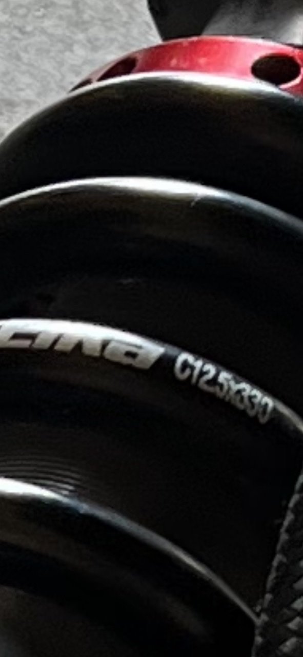

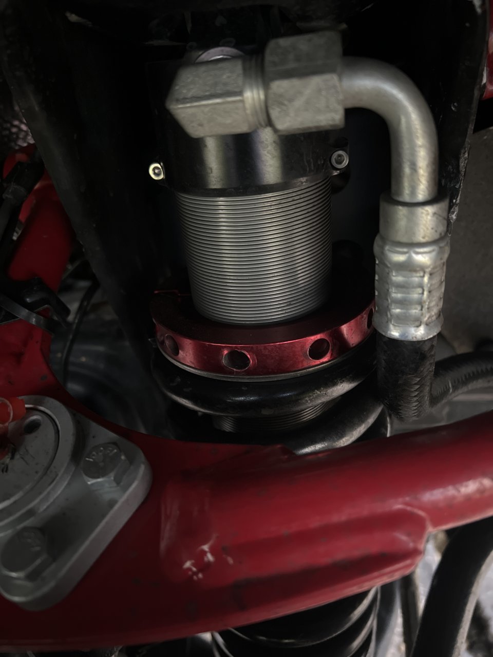

    Howdy all. Common question in a lot of Threads, but still need advice. I have the Elka 1-3” setup. Installed on my 33” tires and had a lot of rubbing. Initially set at factory max preload of 1.27”. I’m now at around 2” of preload to level it. I also have JBA UCA’s. Truck was definitely nose down. I looked up a similar Fox 2.5 setup and saw the preload max was right around the 2” that I now have. I have 700lb springs which should accommodate my bumper/winch combo (not yet installed). So with the coil overs cranked down past factory specs,
    I’m concerned that I’m not going to get full travel and I’m messing with the ride quality.
    Would it be at all advisable to put a 1” spacer up top and crank back the preload back down to close to factory spec, or is that stupid? Pic for your review (factory pre load pic 1), current setup leveled out now with lots of clearance.

    What size coils? It should say right on them by the Elka logo. It's usually measured in mm. Elka also doesn't have a 1-3" option. They have 0-2" and 2-3". I'm guessing you got the 0-2" kit and are trying to get too much lift out of them.
    Having a lot of thread showing above the adjustment collar isn't necessary anything to worry about. If you have a 12" or 13" coil instead of 14" then this is perfectly normal.
    Do not add a spacer above these shocks. If you need more height, that's what the preload adjustment is for. You won't ruin the ride quality by adjusting preload, the spring rate isn't changing. And you shouldn't lose an total travel, just downtravel as you go higher with the lift (relative to stock).

    What @Saskabush said is right on par with what I would say.
    How exactly are you measuring preload?
    Do you know what rate & length springs you have? How about shock lengths? Also need to confirm where they are measuring for lengths.
    The UCA and your alignment specs are probably the issue with tire rubbing. More or less lift will not solve that problem. Our UCA probably would ;)
    To give you a more precise answer, all of that info is needed, otherwise we would just be guessing.

    Let's see, Elka springs are C125x330, rated at 700lbs, I believe stockers are 600. Center of hub to the fender lip is 23.50".

    stock coils on a 3rd Gen are 13” 700# (for the TRD OR)
    your measurement means you have 2.5” of lift since stock is 21” (again TRD OR)

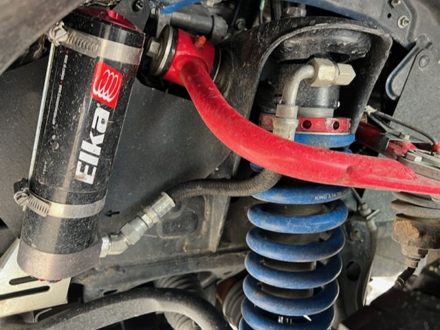

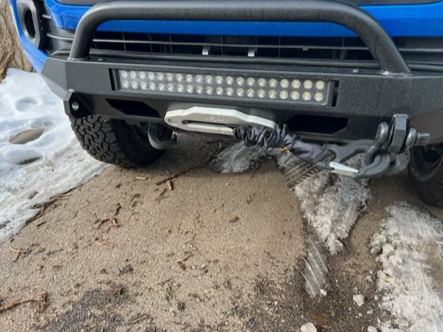

    Here ya go:
    TacoPandaTRD likes this.
  16. Jan 25, 2023 at 11:43 AM
    #16
    Keysmart.info
    Keysmart.info Active Member
    Sep 22, 2021
    #377748
    40
    George
    Ontario, Canada
    2019 Toyota Tacoma TRD Off Road
    Elka 2.5 DC w/ 700 Eibach coils SPC Upper Control Arms JD Fabrications Lower Pivot Relocation 315/70-17 Toyo M/T on Black Rhino Primm Beadlocks Archive Garage Rear Hammer Hangers, shackles & cross member Deaver Stage 2 Leaf Springs w/ U-Bolt Flip C4 Hybrid Bumper w/ 12k SmittyBilt Winch
    Looks very colorful! On a serious note, I also run elkas I actually have a about 2.75” inch of lift after the c4 full hybrid steel bumper plus 12k smitty winch. The amount of threads showing for me is 1.47”. I only notice the suspension becoming very stiff is when I tune the valves on the reservoir to the stiffest settings, both high speed and low speed compressions. I was just curious because I did think on changing the coils, prior to adjusting the preload on the coils. From the pictures I see the coils look very close on the kings it do the not bing when fully compressed?
    p.s elkas have been very smooth for me and I drove same 3rd gen on kings and I feel like the kings were a bit stiffer.
    I also dont have a sway bar so it makes the coils flex a bit more

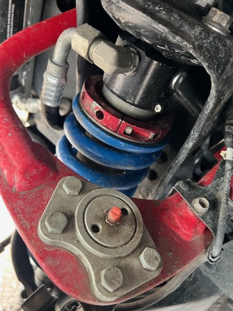

  17. Jan 25, 2023 at 12:00 PM
    #17
    reconrover
    reconrover [OP] Over torquing is my thing..dumbass
    Jul 2, 2021
    #370239
    862
    Pat
    Longmont CO
    2020 Taco Off Road
    Elka front suspension, All Pro rear, with airbags, Decked drawers, Southern Off Road bumper, DRT hangers, Carven Exhaust, Stinger head unit, custom made topper, Vijay swing away rear bumper, etc etc
    This is what I had previously with the 650lb 12.5x330 coils....without the winch bumper. I would bind up on the lower 1/3 of the stroke. I haven't hammered the new setup very hard yet, but what I have plowed through so far doesn't seem to show the binding. Good reminder when it get's a little warmer to start experimenting with the compression and rebound settings to see if I can find the magic setup. For now, this setup corners tight, isn't bouncy, and is pretty smooth through most of the travel....I can actually feel how the shocks work now.
