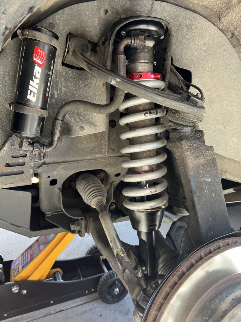

    Ok, so I finally got the truck back after almost 3 weeks of it sitting in the shop, had some complications & accidentally ordered the wrong Inner Diameter coil… so had to re order another one.
    I had the truck for about 2 hours today mostly highway and some street, my first impressions are not so good to be very honest. I think I should’ve went with a 650lbs 14 inch instead of the 700lbs 14 inch coil, the car feels stiff and has less roll, I can probably say it feels stiffer than the original elka coils.
    I have set the damping to the softest setting like it was before didn’t really even make a difference.
    I am currently sitting at 3/4 of thread showing and the truck is perfectly levelled.
    My Ella coils were at about 1 1/2 inch of threads showing.
    The shop couldn’t do the alignment so it drives like crap now. Tomorrow I will get it properly aligned and hopefully it doesn’t feel like a shopping cart and handles better.
    For now I’m not really impressed with how the suspension feel changed.
    by the way I went with Eibach 700lbs 14inch coils. Here’s how it looks.
    The coilovers have been rebuilt and have all new seals, oil and cooling gas, I am wondering if I need to kinda give them some time to “break in” the new hardware I guess?
    BTW I dig the new color look though stands out a bit more now

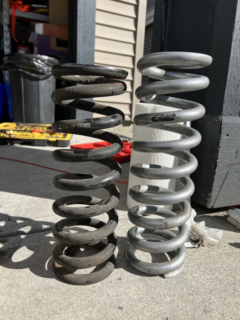

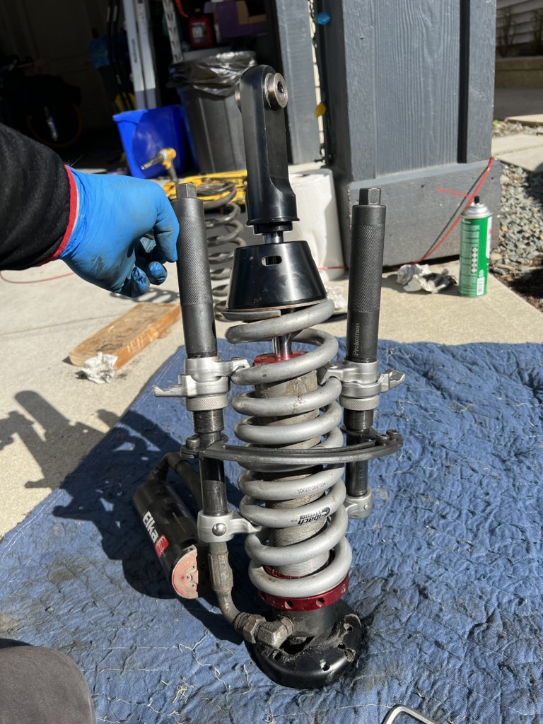

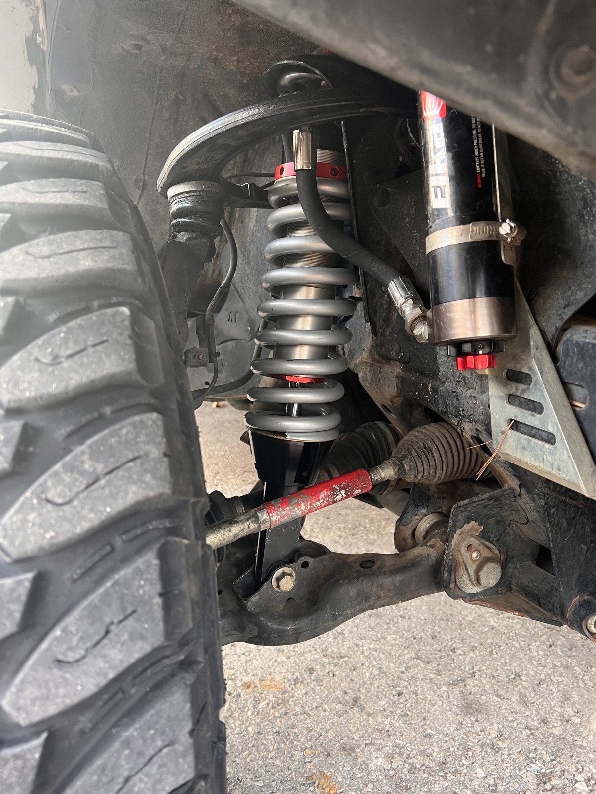

    Reviving an old forum to share my experience with swapping coil springs in hopes that this will help someone else in the future.
    I have a 2020 off-road short bed and at the time I had a 2.75” lift with full RCI steel skids and All Pro Apex steel sliders. I am running Elka 2.5 resi non-adjustable suspension. With the original Elka C12.5x330 (Elka claims they are rated at 700 lbs) coils I had the coilovers set with 1.75” preload on drivers side and 1.25” preload on pass side. I then installed a Warn steel bumper and Warn 10K winch. With the added weight my front end sagged significantly giving me less then 1.5” of lift. When I would brake my front end would do an extreme nose dive and the overall ride quality was terrible. It was a very jarring, harsh ride when sitting so low into the suspension travel.
    I contemplated about adding more preload but didn’t want the coil to bind and didn’t want to make the ride quality even worse! That’s when I got in contact with @Keysmart.info and he helped me out. I decided to go with Eibach 14” 700 lbs coils. Part number is 1400.300.0700S. I installed them myself in a few hours and went for an alignment the next day. With the stiffer and longer coils I was able to improve ride quality, reduce preload, and gained height back to give me a full 3” lift. My preload now sits as 1.25” driver side and 0.75” pass side. I couldn’t be happier with the way my truck drives and looks!!!
    I have more pictures and information of my truck build on my instagram @ TacoPandaTRD
    Elka 12.5” vs Eibach 14”
    Truck sits almost level. 1” difference between the front and back.
