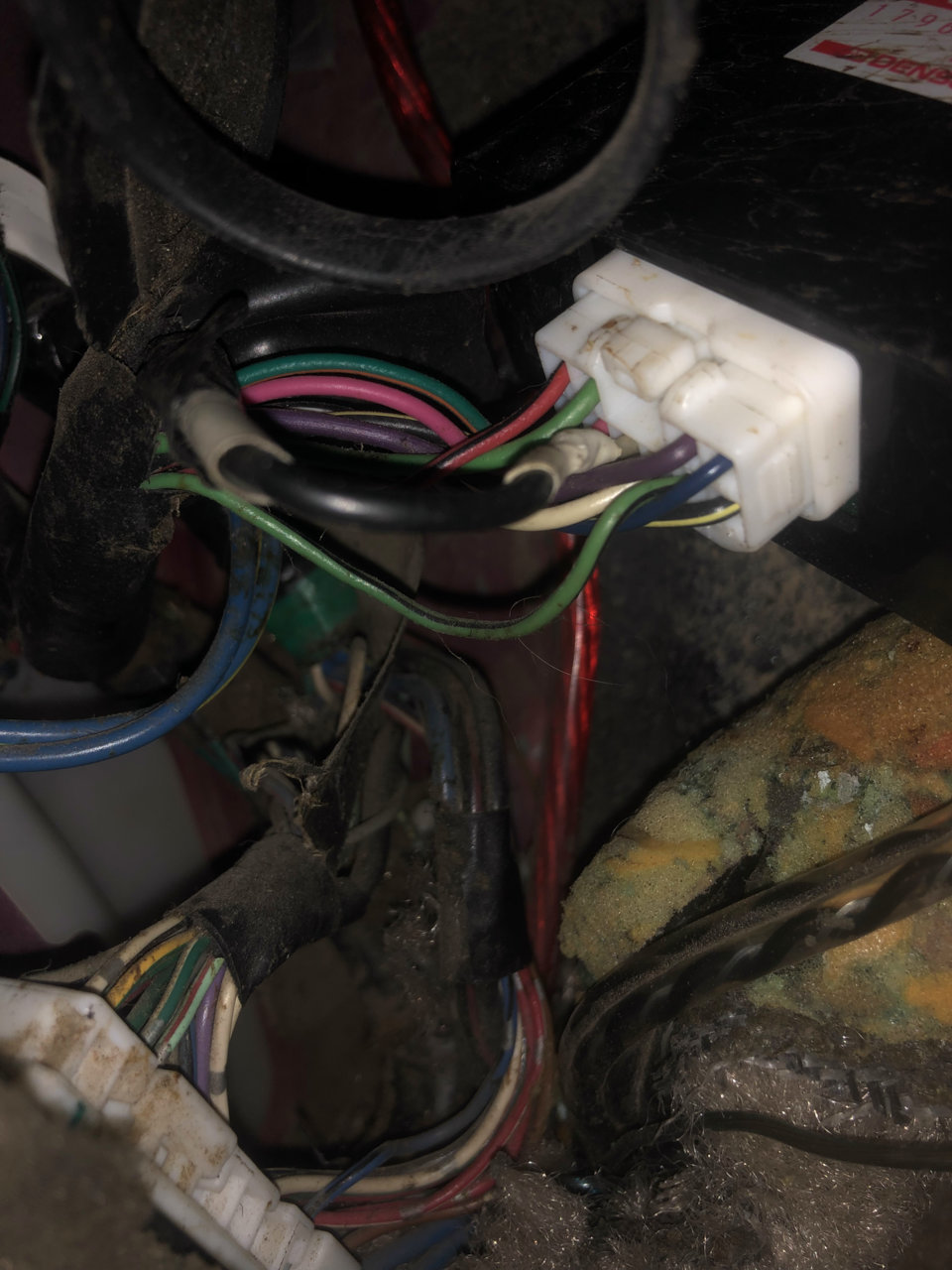

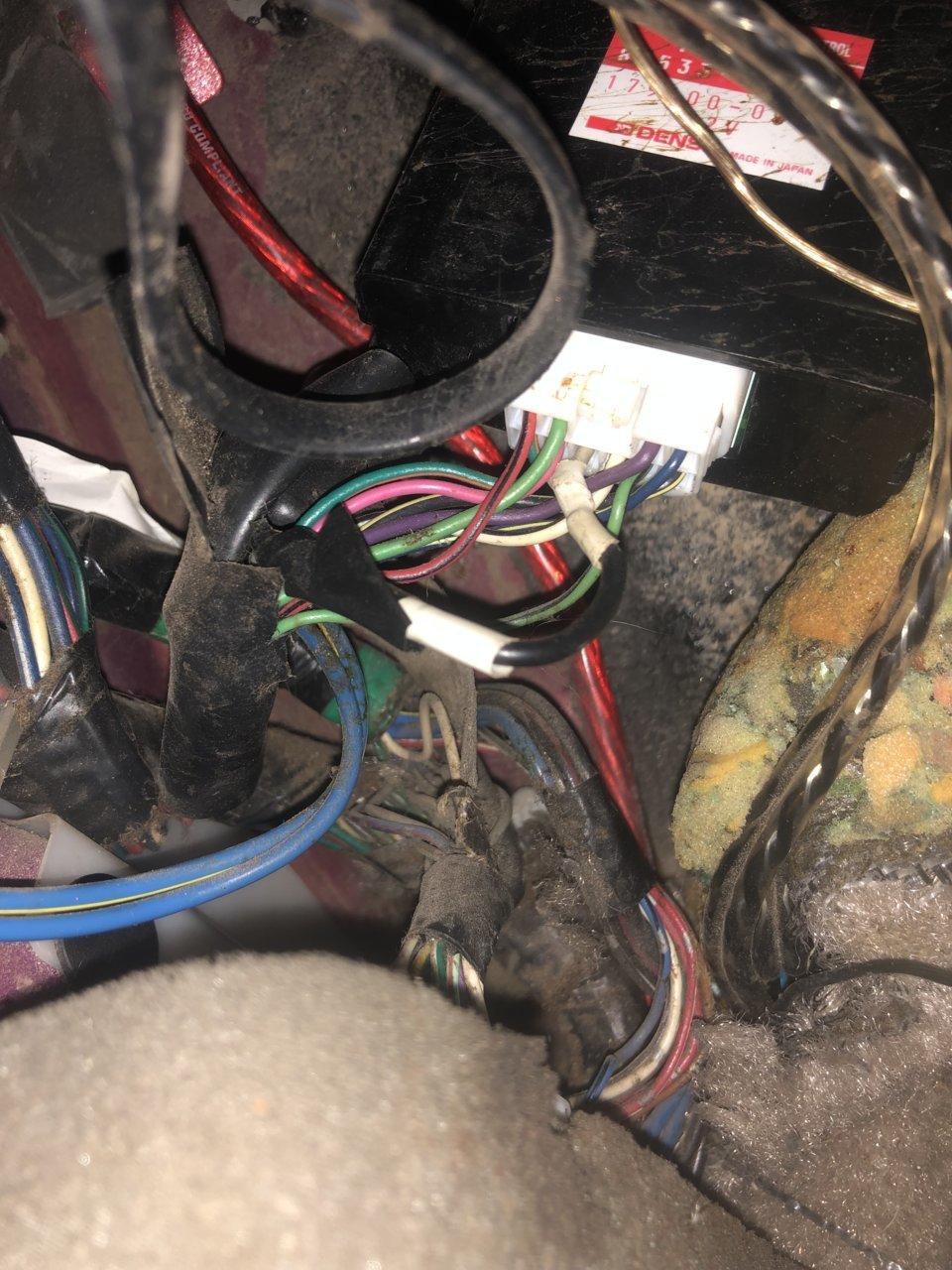

    I just in here and for sure the grey wire mod has already been done but they ran the extension deep with the other cables all taped up together. and for sure the diff doesn't lock currently when in 4H. Should I cut what's already been done here and try to make my own ground again to see if it will work? also will the remaining other side of the wire (not ground) be hot and potentially a fire starter?

    Add a ground to that extension and see if the locker will engage without being in 4lo.

    Ohhhhh maybe this grey wire mod pre existing work was actually a repaired grey wire 0.0 that would make sense. For whatever reason maybe the last owner went back on this mod and what I’m looking at is a repaired spliced wire. I believe it used to be like glued fixed diff before my ex blew it up and we had it rebuilt new again

    when you say add a ground you just mean jimmy Jack into the grey wire once again and make it into a ground ? Or like a 2 way Y split in the wire ?
    Forgive my mechanical ignorance man I’m on day 4 of converting from the powersport junkie into the repair supplier

    I peeled back the tape to get a look at what’s going on. I’m gonna cut and cap the grey wire leaving at the top, discard the mending, and connect the new ground where the green circle is gonna hit AutoZone rn to get some of this small gauge wire

    Good work- that's the right move. Mixing gauges like that is not awesome.

    is the useless end of the OG grey wire gonna be a hot wire capable of starting a fire?

    WOOT WOOOOOT grey wire mod was a success! Super stoked. I know its one of the easiest jobs out there but this helps me gain faith in the idea of doing my own work from here on out and not getting taxed by the shops over and over and over.
    Appreciate all your guys insights !! Thank you all. She'll be capable of duning now with locked diff 2H and less likely of getting completely stuck n screwed in the sand.
