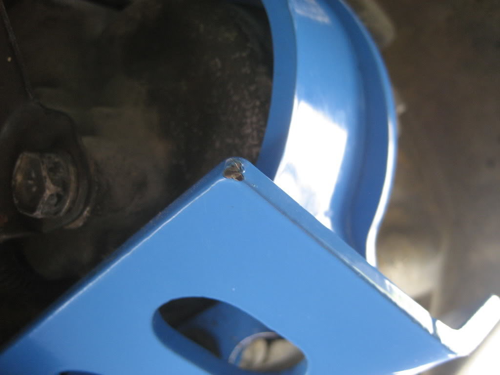

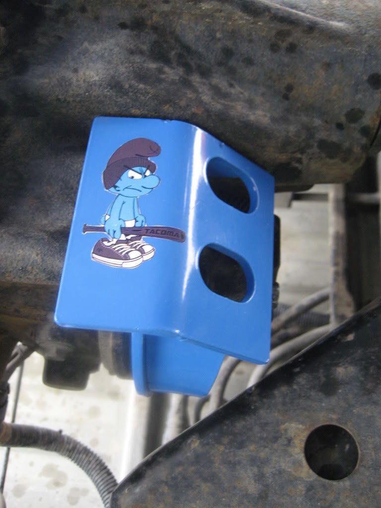

    Of the three listed by the OP, go with the inchworm. It's solid, has more coverage, and the fit and finish is way nicer. I had to notch the corner of mine to clear the gas tank skid at full flex though.

    The inchworm utilizes 3 of the factory nuts that are on the 3rd memeber.
    The wires are on the top of the actuator on top of the 3rd. There's no way you could even hit anything near the wires.

    me too! I am ordering one next week! I like how low profile it is and protects both sides.
