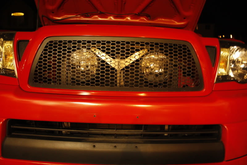

    There are 3 radiator sides and the center lower I did not want to bolt it in my truck. And it is solid!!!

    I live in damascus but I work in Beaverton near Toyota mon-fri 8-5 I dont have it on my truck bc its a xrunner just pm me I will have some with me tomorrow just pm me

    Gee thanks gabe ha that's my 3d model ha

    100 for stainless or 85 for steel + shipping not sure if I'm going to offer a powder option yet bc of the different size holes for the lights right now they are set for Hella lights I'm not sure if all the lights have that size hole

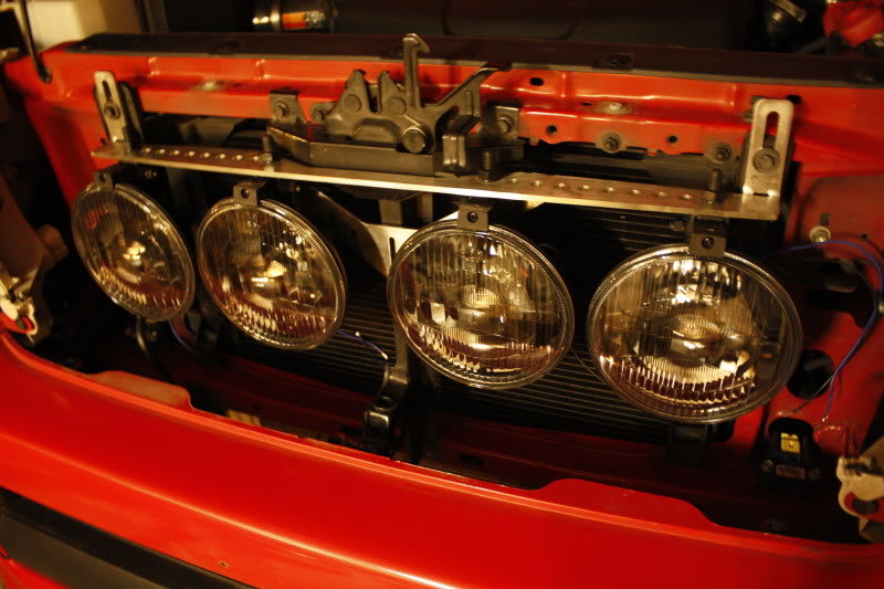

    Looks good, but I would have some kind of extension to move lights further forward for those with the factory Transmission cooler. with the lights that far back they will hit the factory cooler.

    1,155
    portland
    I'll test it asap

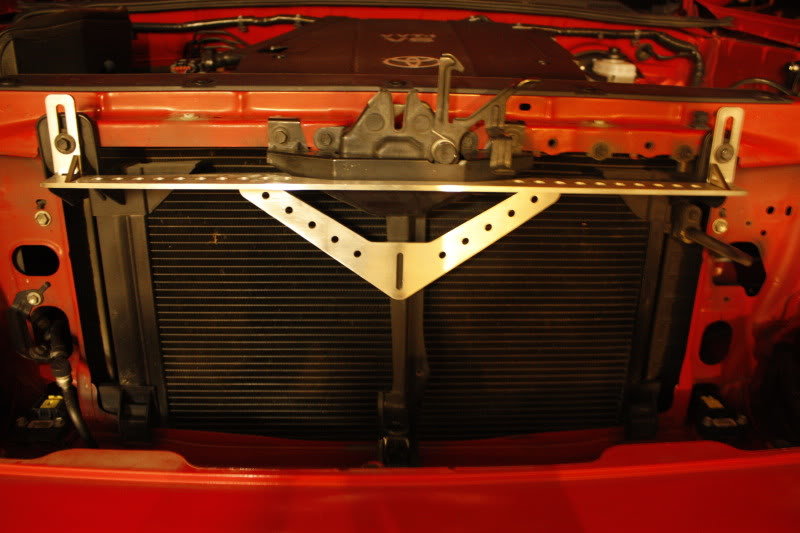

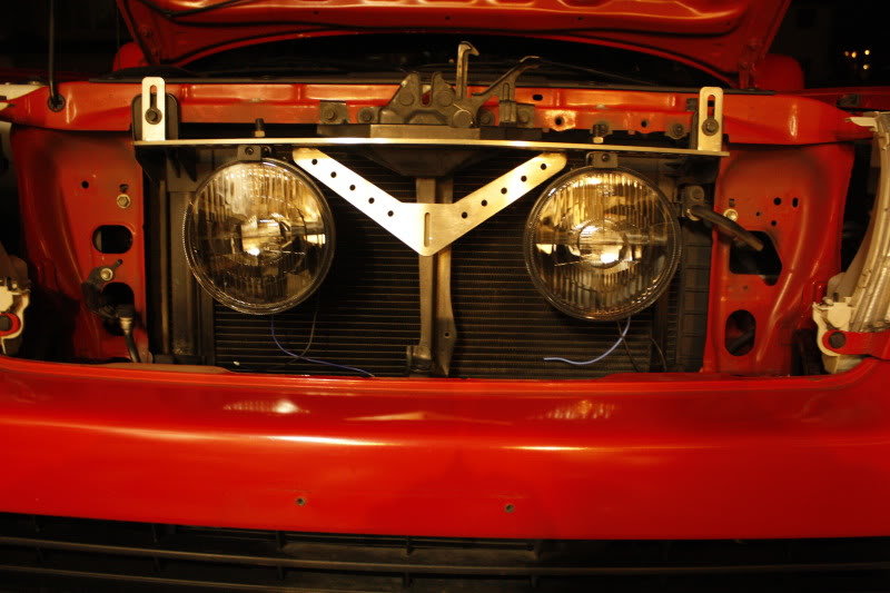

    Blacked-Out Badges; Retribution Decals (Sockmonkey); Tailgate Mod; Red LED Rear Blinkers; Yellow Foglights; Yellow Front Blinkers; Superwhite Xenon Corner Bulb; Leer Bedcap; Bedrug Bedmat; Black Cupholders; Black Plastic Piece Around Window Controls; Plasti-Dip Front Bumper Valence; Plasti-Dip Grill Surround; Blackout Chrome Back Bumper; Metal Miller Skid-Plate; Aero Turbine 2525 Muffler; TSB Rear Leaf Springs and Shocks; Satoshi Grill Pending; Off-Roading Torn off Mirror (Replaced); Blue-Sea Fuse Box; Tinted Tail Lights; URD Short Shifter; Interior Mood Lighting; Hood Lights; BedLights Pending
    After looking at all these pics I'm still not sure what the "V" section is for. Bracing maybe?

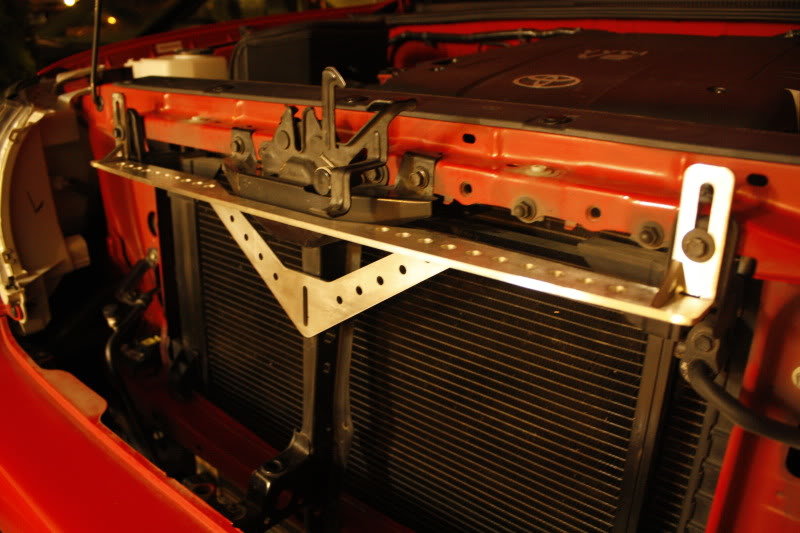

    1,155
    portland
    Yes support in the center and the third bolt location, you can also mount other lights on them

    1,155
    portland
    The production pieces will be tig welded not bent as well as gussets on the outer 90s

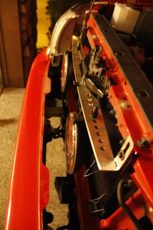

    08 DBLCAB LB TRD Sport
    Lift & Tires, in cab power outlets, Locking Bed Boxes, K&N
    How much space is left between the (Not Satoshi) grill and the lights? How much room for forward adjustment?
