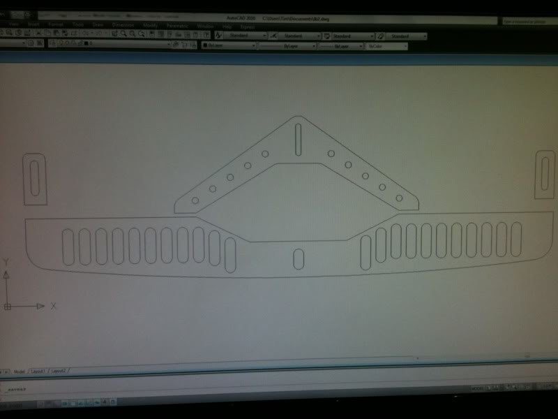

    OK REVISION 3 "NAILED IT!!!" So you now have 1.2" of adjusment forward it still clears the satoshi grill and will work great for the standard insert. The hole sizes are .5" now so if you are using the hellas you just have to add a washer no biggie but it will work for a whole array of lights now. I also added a center hole location for all you three eye monsters.

    :thumbsup: You NAILED IT Damn Good
    When installed, lights will adjust UP & DOWN, FORWARD & BACK, and our Tacoma's will FLY.

    The lack of horn relocate (my alarm is in the normal spot for that) almost made me reconsider butthe revision with it fitting my tow package and third light has mad me decide I will get it... in stainless.
    I DO want to see a report of no light bounce though as thats the primary reason we are getting this.
