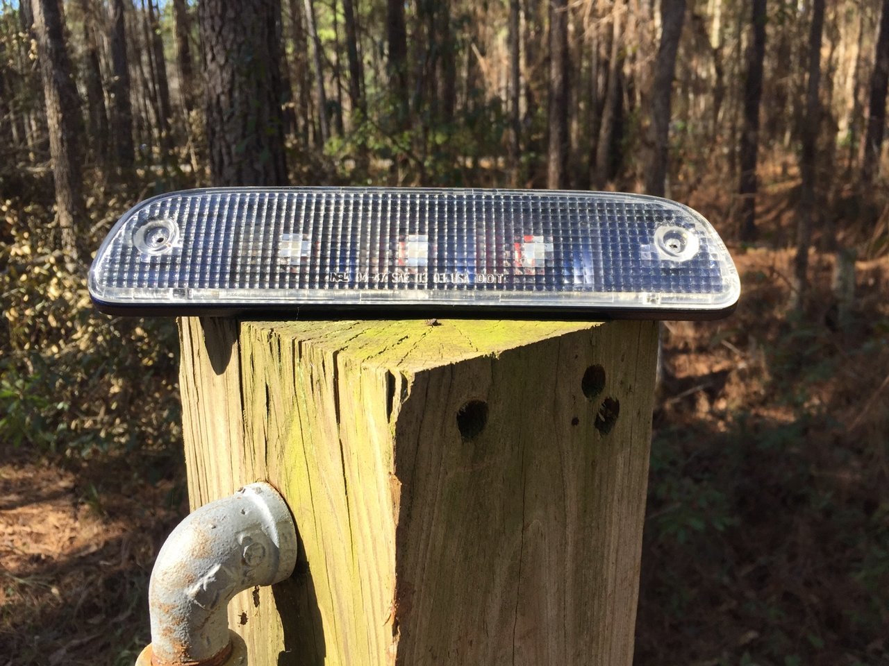

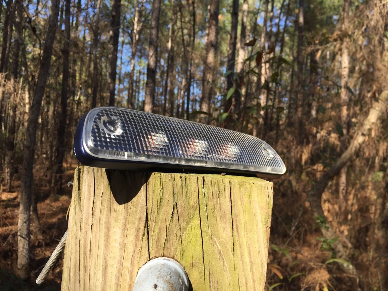

  4. Feb 18, 2016 at 12:28 PM
    #224
    Boogyman
    Boogyman [OP] Well-Known Member
    Aug 17, 2012
    #84975
    13,328
    Phoenix
    Corpus Christi, TX
    2022 Lunar Rock Trail Edition
    Got my personal 3rd brake light finished up finally
    SC2SC, 3milecreek and AR15xAR10 like this.

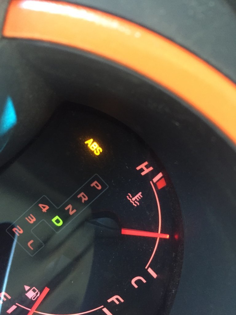

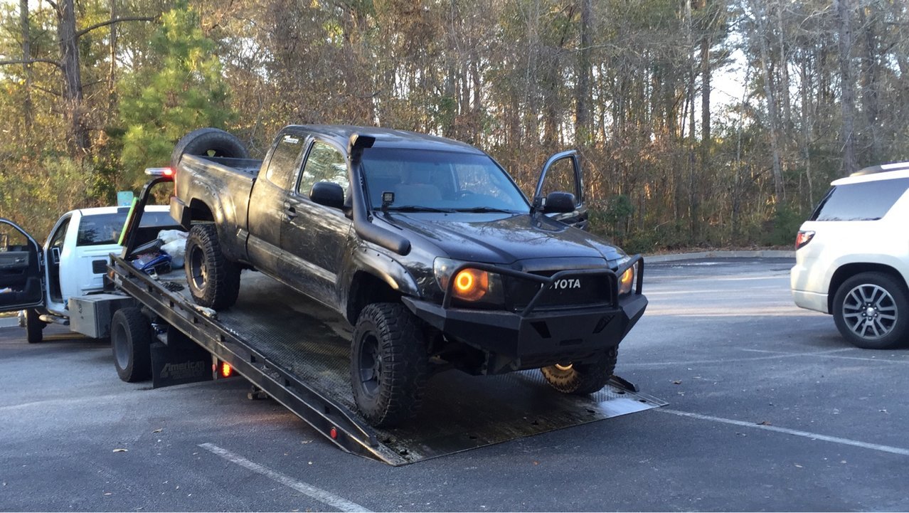

  9. Feb 20, 2016 at 8:29 PM
    #229
    Boogyman
    Aug 17, 2012
    #84975
    13,328
    Phoenix
    Corpus Christi, TX
    At 266,340 miles this happened...
    SC2SC and AR15xAR10 like this.
  10. Feb 20, 2016 at 9:05 PM
    #230
    AR15xAR10
    Apr 13, 2013
    #102024
    57,026
    2013 TRD Sport 4x4 V6 ACLBFTMFW
    Fix this busted ass shit yet?
  11. Feb 20, 2016 at 9:05 PM
    #231
    Boogyman
    Aug 17, 2012
    #84975
    13,328
    Phoenix
    Corpus Christi, TX
    No... :pout:

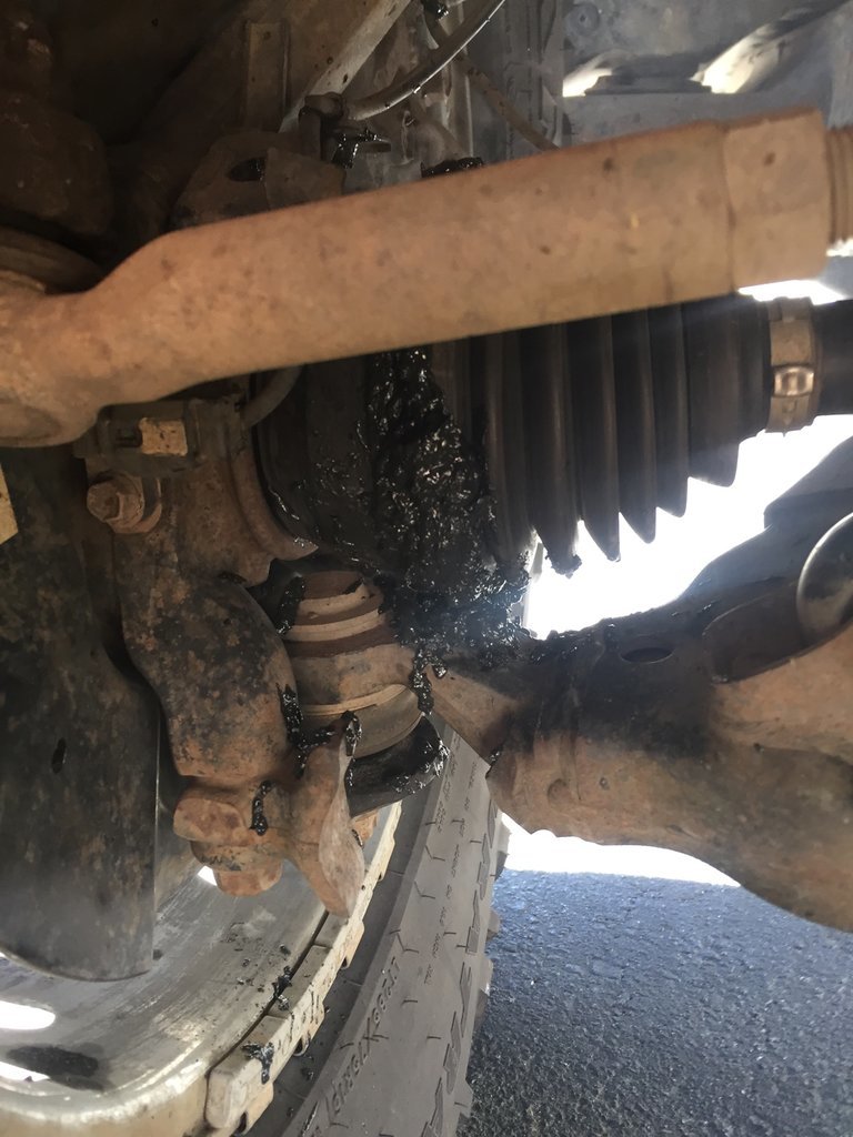

  15. Feb 21, 2016 at 12:26 PM
    #235
    Boogyman
    Aug 17, 2012
    #84975
    13,328
    Phoenix
    Corpus Christi, TX
    Found my brake problem
    https://vimeo.com/156182054
    Rotor became unseated making it rub the caliper and it got so hot it fucked the CV boot.
    At the same time I installed my UCAs finally
    I'll resurface my rotors and then put it all back later in the week
