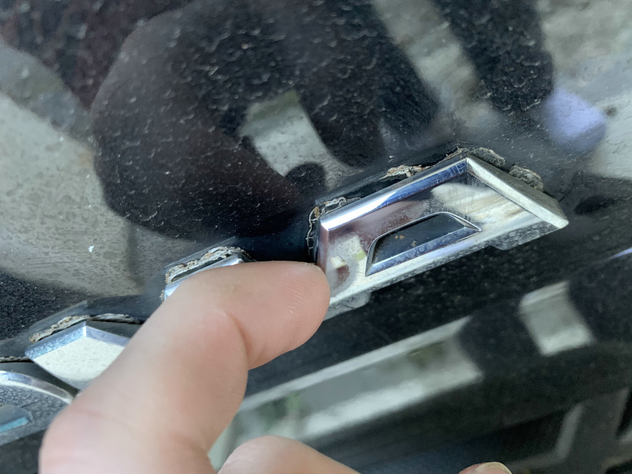

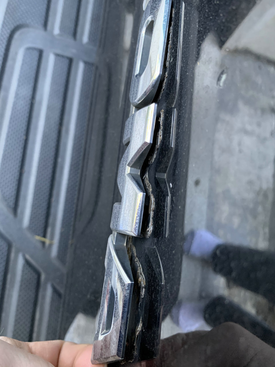

    Hello everyone, I have a 2007 Tacoma TRD Sport. I have about 190k miles on it and it still runs and looks amazing. Unfortunately on my tailgate, I have a few emblems falling off, this is actually no surprise to me because I do wash this truck frequently. (not lately due to work) I was wondering if you guys had this issue and if so how did you fix it. I do not want to disturb the paint because after 13 years the paint still looks very good. The tailgate is not the original tailgate,

    You need a Double sided 3M Tape from Auto Parts Store! Take off gently,clean emblem back with a razor and clean residue off tail gate with alchohol . Retape emblem and reapply after thorough cleaning !

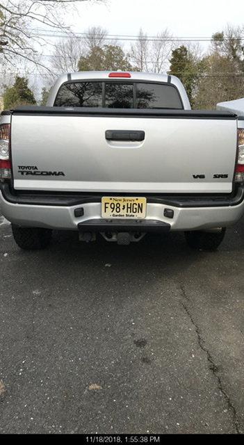

    I would remove them . You can use fishing line or dental floss and basically saw through the glue. Then follow up with goo gone. If you still want emblems ebay has full kits for very reasonable price. I changed mine over to black. They were they same size C5BD470C-A8C2-4DD4-BE2D-C3AB1E5D429F.jpg

    Thanks, guys for all the helpful info I really appreciate it. I got the emblem off and cleaned the back of it and the tailgate and got all the excess glue off. I cleaned the tailgate well and used the 3m emblem adhesive glue and reapplied it. To get the glue off I just used diluted mineral spirits and a heat gun. It should hold for a while haha.
