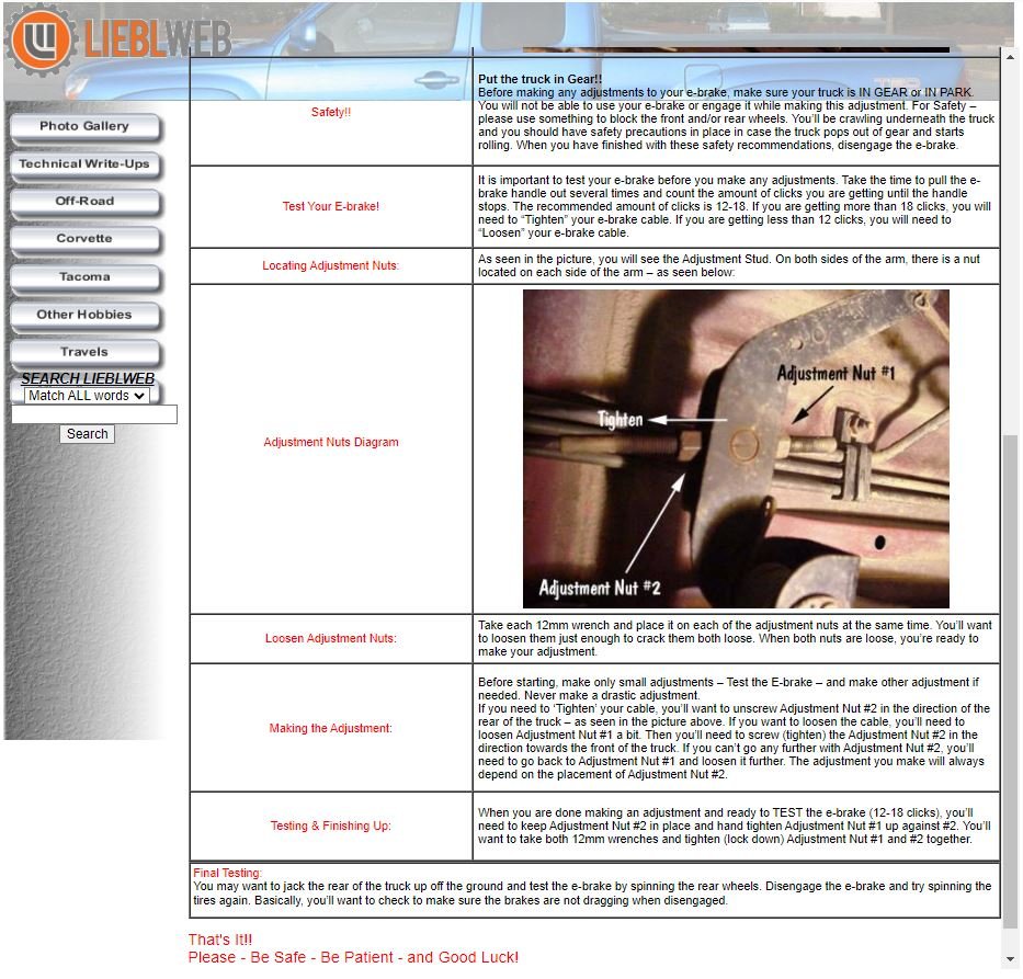

    I'll have to take a look at mine tomorrow as well, having same issue where hopefully adjusting the tension will fix it.

    While you’re in there make sure the brakes apply and release, mine is an 02 double cab and it wasn’t releasing. I found the piece at the backing plate with a rubber cover was seized, I took it apart cleaned it and lubed it.
