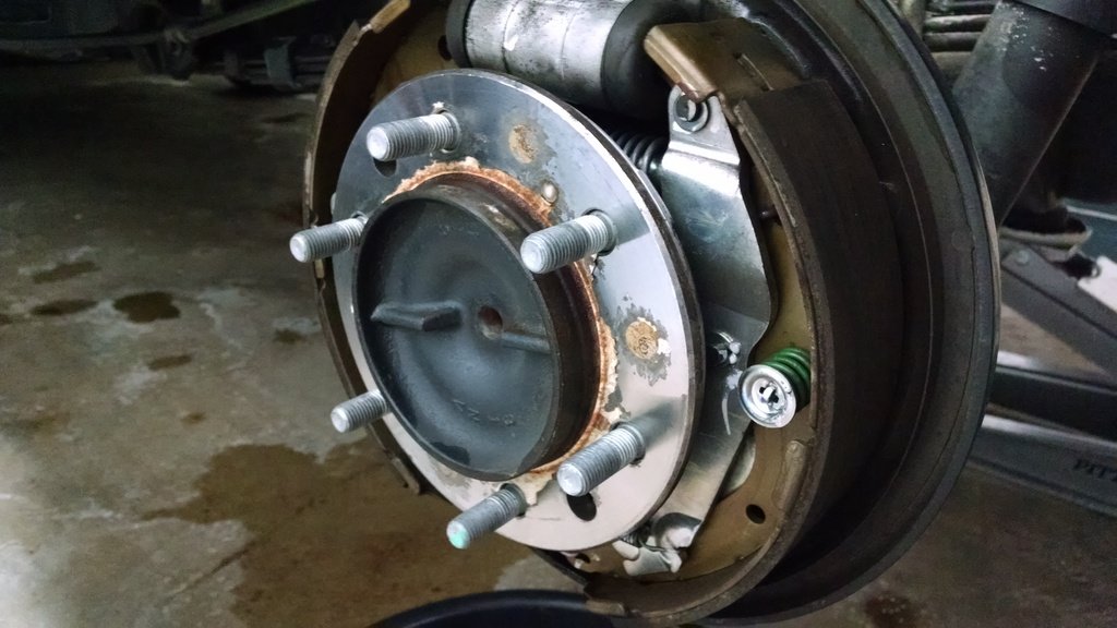

    No issues were noticeable
    Brake cleaned both sides. Was nice to begin with... Only 30k mi on truck
    This time it was the driver's side. 2 weeks ago it was the passenger's side.

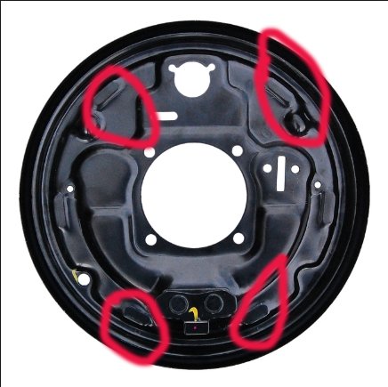

    most common issue is the backing plate that the shoes make contact with. There are raised sections that the shoes rub against, sand them down with some 1000 or 1500 grit sand paper then hit it with some brake lube. also clean and lube all of the moving parts (joints, contact pads etc). This worked for me.

    Did you find the solution? Mine has been doing this for years! Thanks for the info.

    I saw those areas today and wondered about them.......
