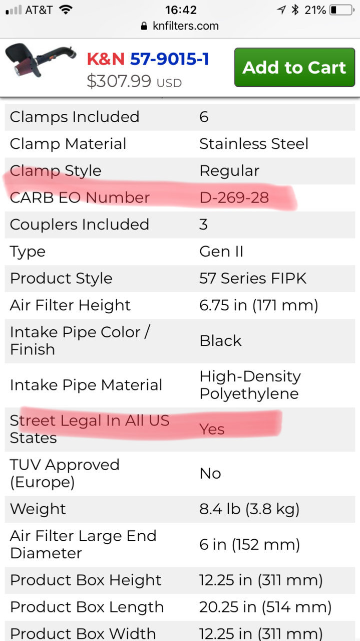

    K&n carb number, they only offer two different intakes and both are carb legal. If you need the sticker i would call them and see about getting a new one

  8. May 16, 2018 at 10:42 AM
    #88
    Sperrunner
    Sperrunner UA342
    Feb 23, 2018
    #245334
    49,991
    Miguel
    El Cerrito, Ca
    2023 Ford F250
    Its the company truck
    And i have no clue on the cats, i just know that all cats replaced in cali have to be carb legal, bo shop should sell you one thats not

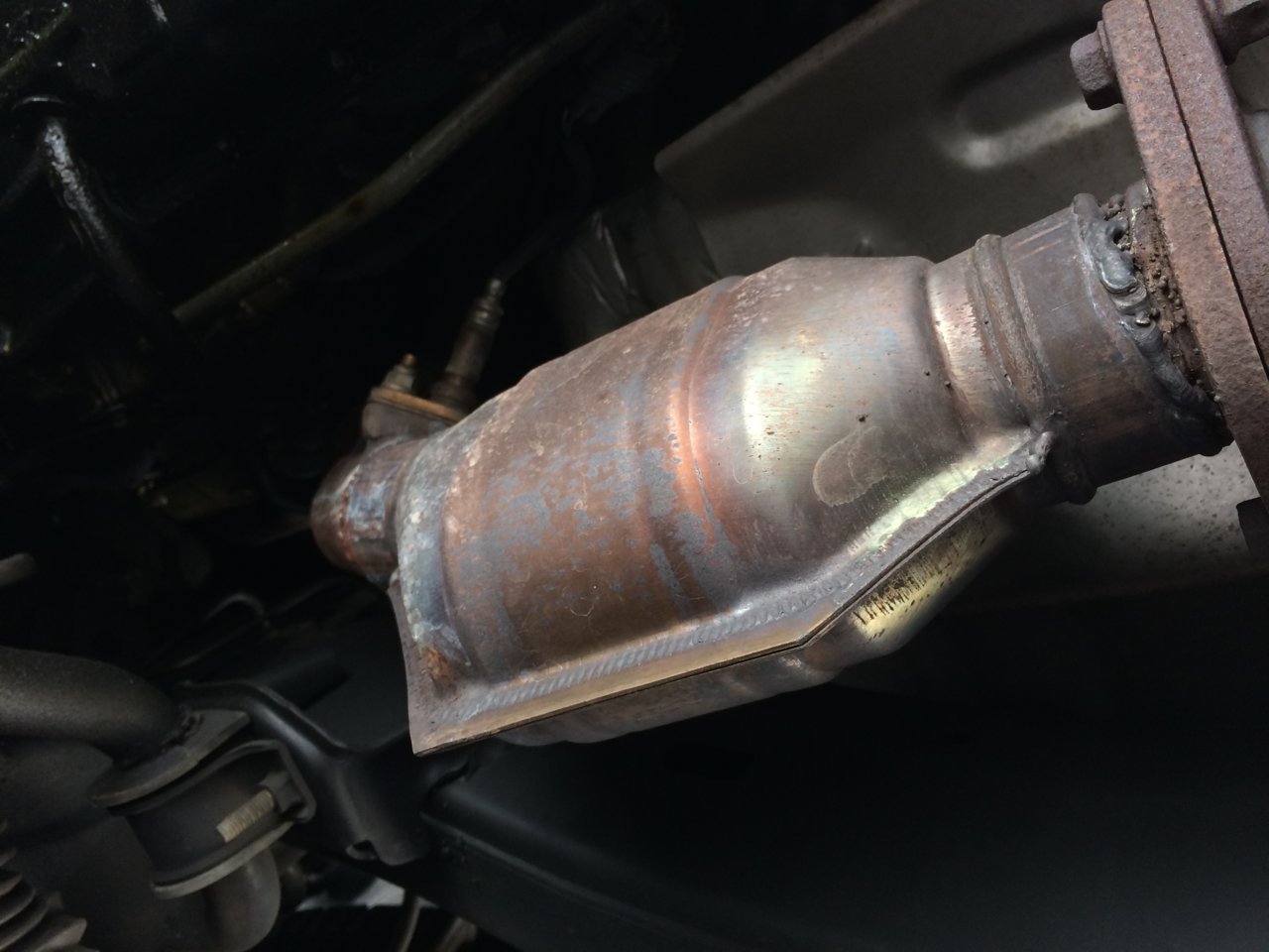

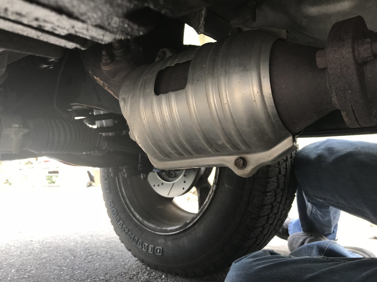

  17. May 16, 2018 at 11:10 AM
    #97
    2000 Tacoma Black
    2000 Tacoma Black [OP] Well-Known Member
    May 12, 2018
    #253273
    203
    2022 Tacoma DC Off Road / 2000 Tacoma Prerunner
    Your's looks like my back cat (OEM I believe), with the heat shield and all. Is yours OEM?
    THis is my front cat. By the way, does this even look legit?

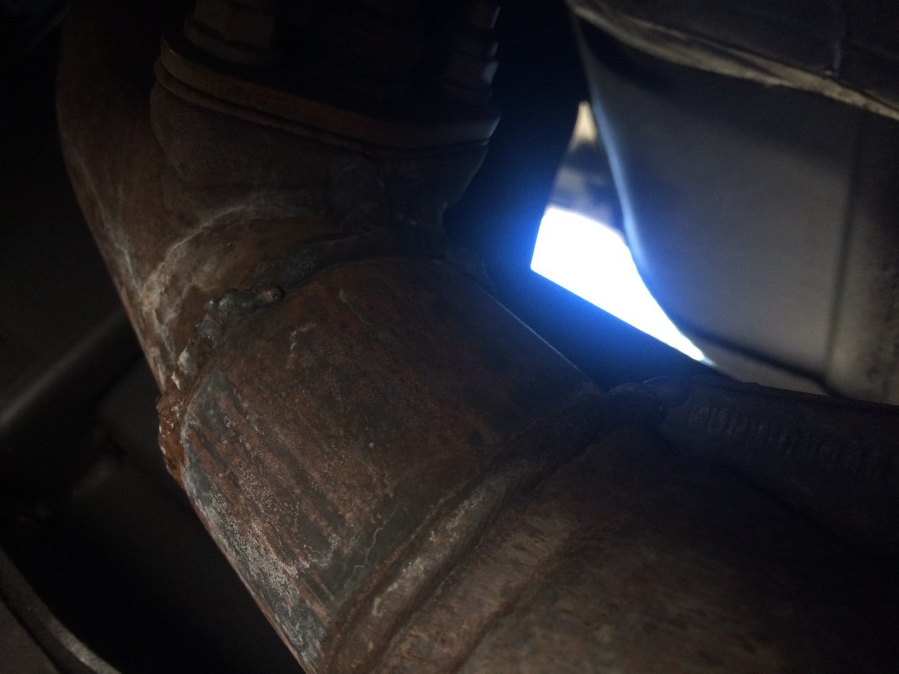

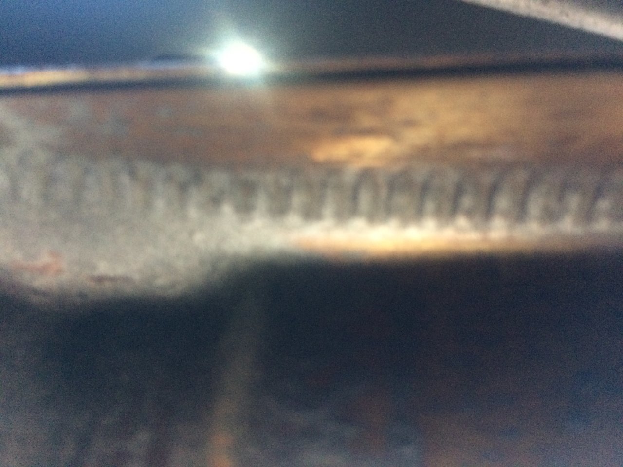

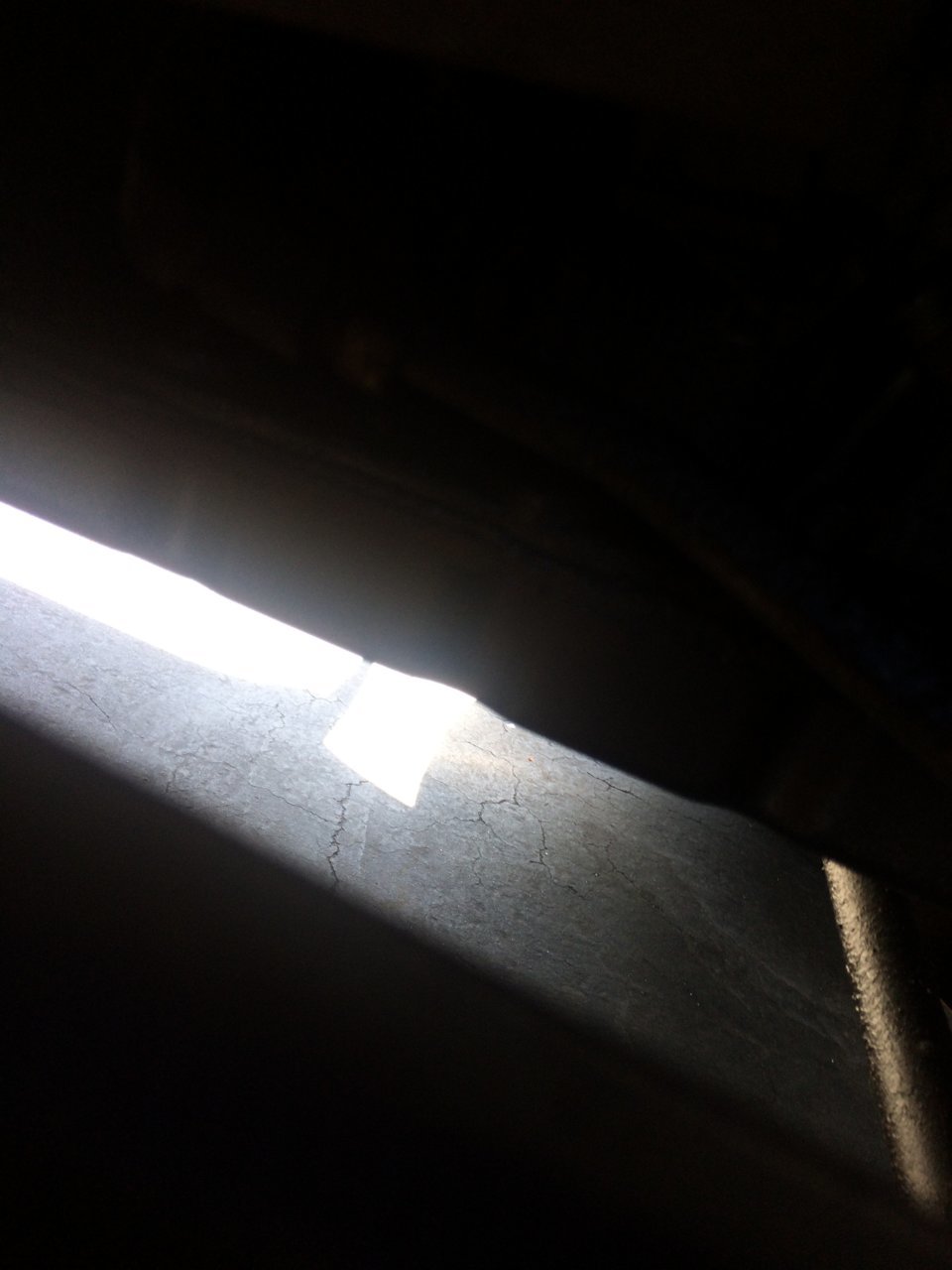

  18. May 16, 2018 at 11:13 AM
    #98
    2000 Tacoma Black
    May 12, 2018
    #253273
    203
    So I looked and used my phone to take pics where I couldn't get eye level views. No number that I know of is on this thing.
    Not the best photos, I know. Best I could do

  19. May 16, 2018 at 11:24 AM
    #99
    frizzman
    frizzman Well-Known Member
    Sep 25, 2013
    #113212
    5,348
    Pittsburgh, PA
    04 XCab 4x4 TRD/OR
    OME 2.5,Tundra 17s,Falken Wildpeak AT3W hitch w/ 7-pin, ARE cap, JVC HU w/BT, HID/LED lights
    looks like yours was already replaced once. Toyota uses flanges, that one is welded on.
  20. May 16, 2018 at 11:28 AM
    #100
    Sperrunner
    Sperrunner UA342
    Feb 23, 2018
    #245334
    49,991
    Miguel
    El Cerrito, Ca
    2023 Ford F250
    Oem ones bolt in, even the magmaflow ones bolt in. That doesn’t look oem, ik you said it was replaced before. I would contact the shop that did it and see if they have a clue
