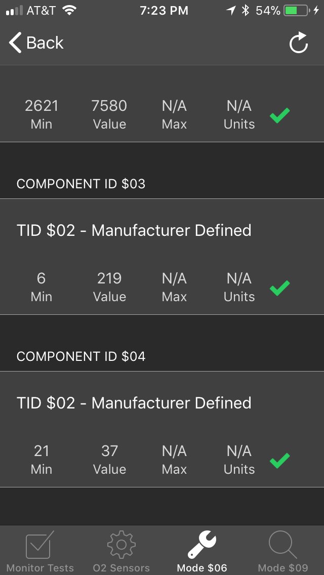

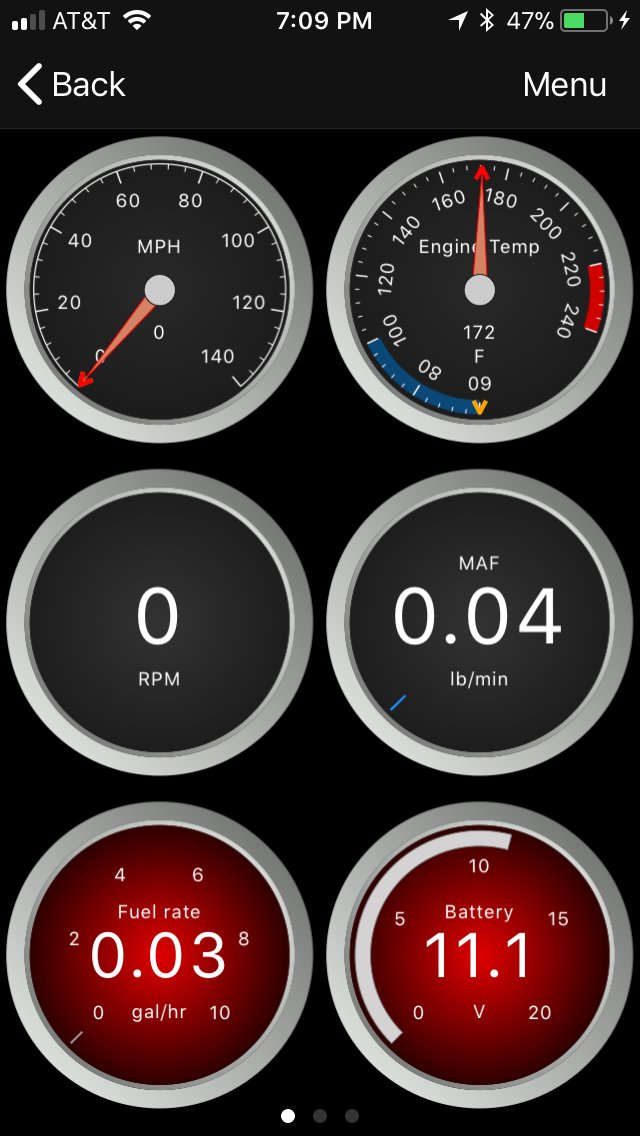

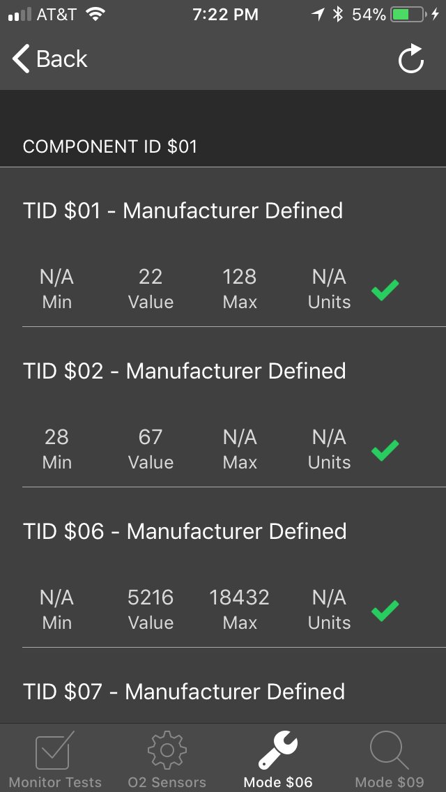

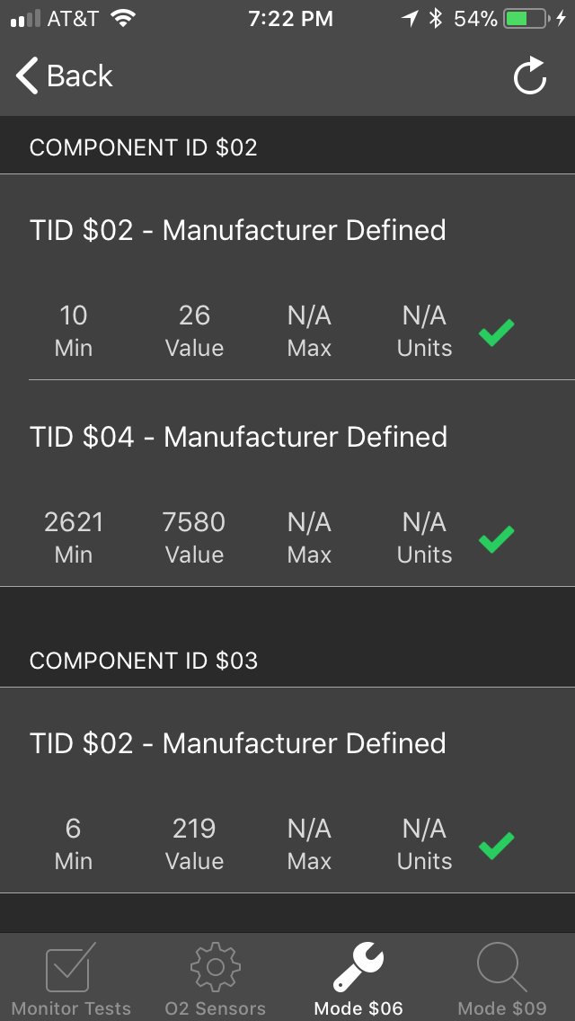

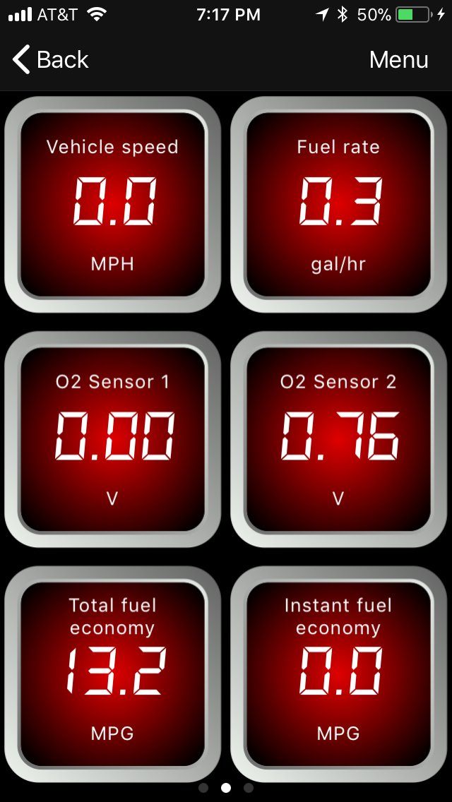

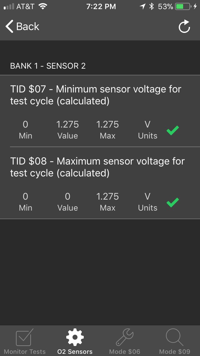

    UPDATE: Shop called me back on front cat installed in 2014. Got the EO# Andy part#. Check.
    Received OBDII reader in the mail, plugged it in. Here are some results:
    Key in ignition, engine off:
  15. May 17, 2018 at 7:38 PM
    #115
    2000 Tacoma Black
    2000 Tacoma Black [OP] Well-Known Member
    May 12, 2018
    #253273
    203
    2022 Tacoma DC Off Road / 2000 Tacoma Prerunner
  16. May 17, 2018 at 7:40 PM
    #116
    2000 Tacoma Black
    May 12, 2018
    #253273
    203

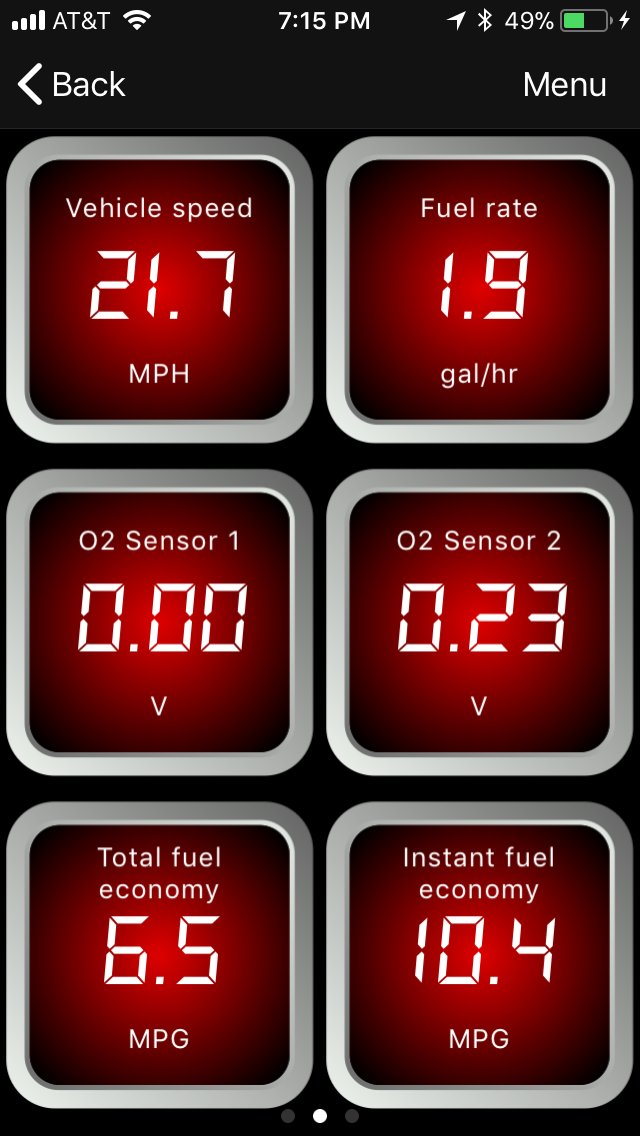

    21 mph

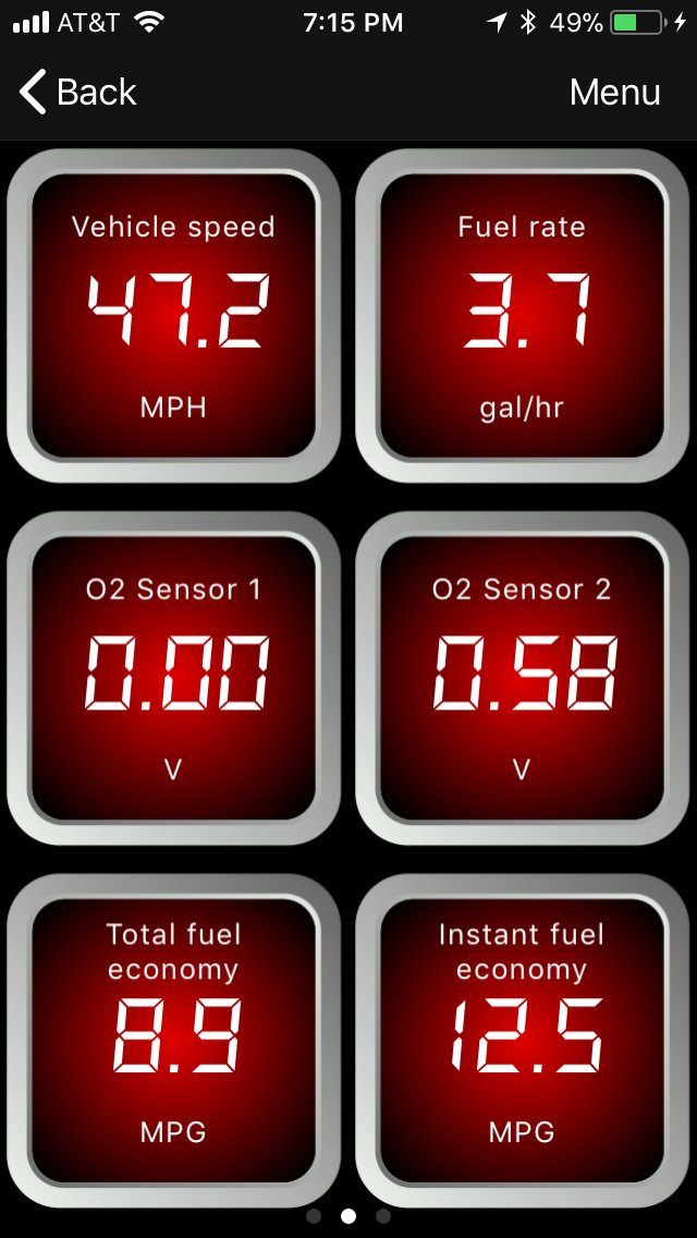

    Went out and took it up to 45mph:
  17. May 17, 2018 at 7:41 PM
    #117
    2000 Tacoma Black
    May 12, 2018
    #253273
    203

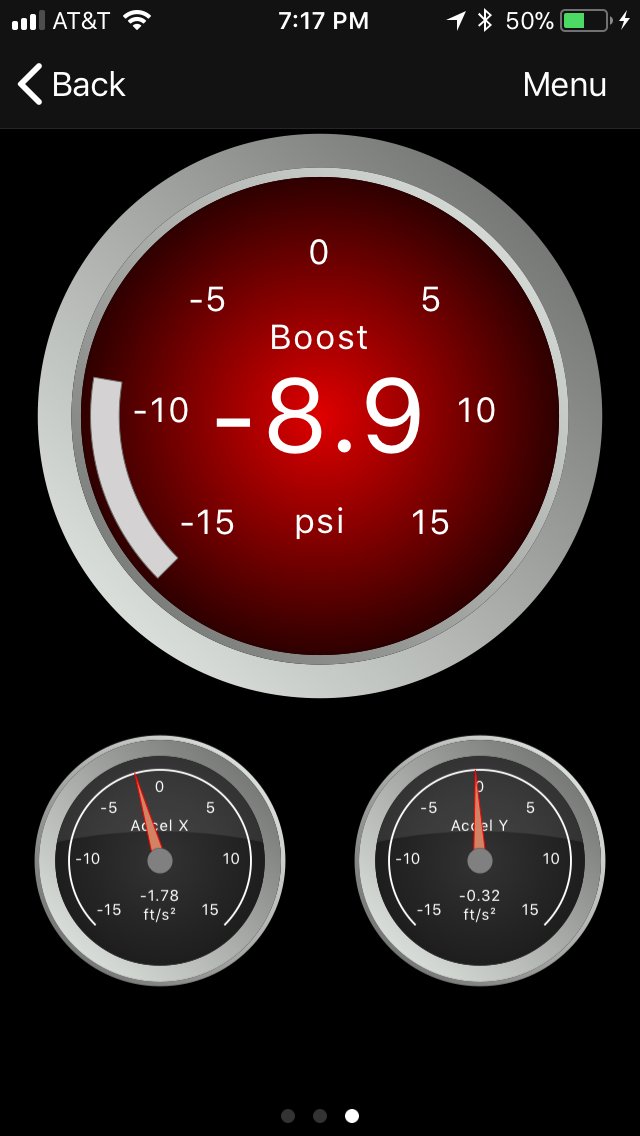

    Back at idle after 45mph:
  18. May 17, 2018 at 7:43 PM
    #118
    2000 Tacoma Black
    May 12, 2018
    #253273
    203
  19. May 17, 2018 at 7:43 PM
    #119
    2000 Tacoma Black
    May 12, 2018
    #253273
    203
  20. May 17, 2018 at 7:46 PM
    #120
    Sperrunner
    Sperrunner UA342
    Feb 23, 2018
    #245334
    49,991
    Miguel
    El Cerrito, Ca
    2023 Ford F250
    Its the company truck
    Your air fuel raito should be 14.7 always, there is something wrong
