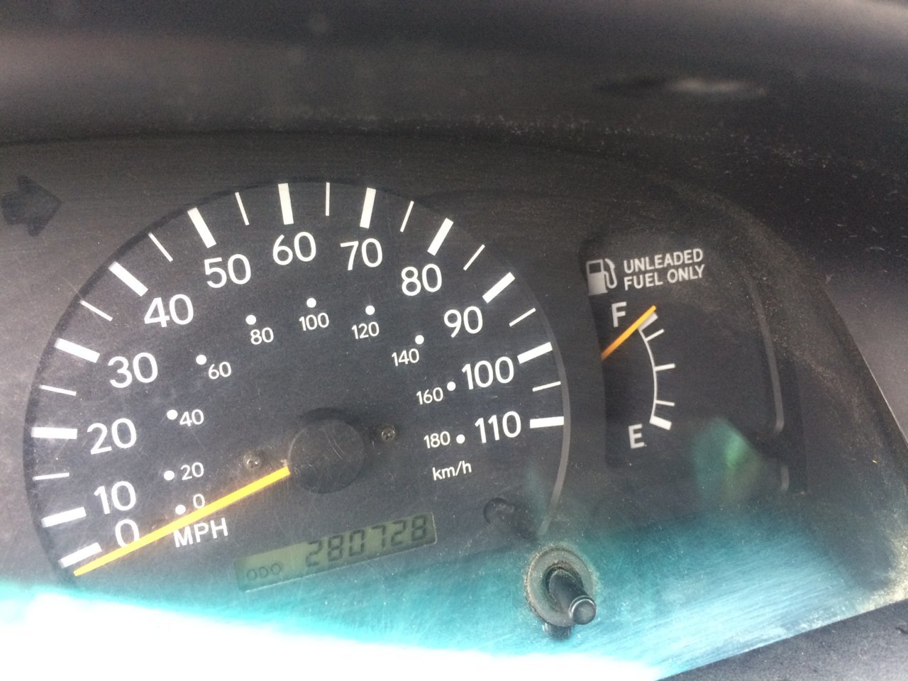

    So I cleaned the K&N air intake filter with the K&N Recharger kit. The CEL code P0420 disappeared. I never did clear the code with the OBDII scanner, it just went away this morning when I started the car after putting the cleaned intake filter back on.
    It may come back on, I don't know. But I wasn't expecting that code to go away right when starting the Taco up.
