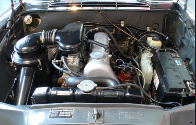

    Here's a picture of one with the dual carb breather.
    JudoJohn, Biscuits and Empty_Lord[OP] like this.
