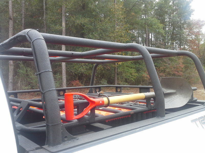

    All Pro Offroad bed rack Defender Basket OME/Dakars Total Chaos ucas C4fabrications LoPro Smittybilt 9.5 comp Uniden 520xl (tuned) CVT Mt. Shasta Black Oak 50 curve led
    The problem with it is, once it is dented or crushed, ie. by securing the rtt, the damaged areas will create weak points that will cause a failure. I would not use it, imho. Get some good tubing, rtts are heavy to begin with, then you have to account for the wieght of who ever is climbing in and out of it. Spend the money on good metal
