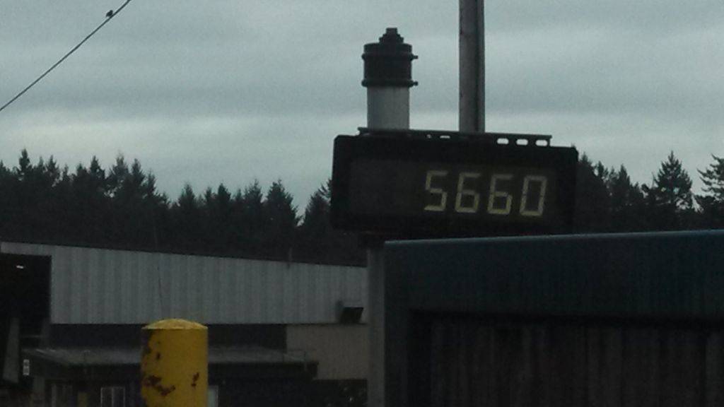

    My DC/LB has a daily driving weight of 5660lbs: Leer Canopy, Sliders (.188" wall), ARB front bumper, Warn 8k Winch w/ Syn. Line, IFS & Mid skid (one-piece), full sized spare, FUll recovery tote + recovery gear, etc.

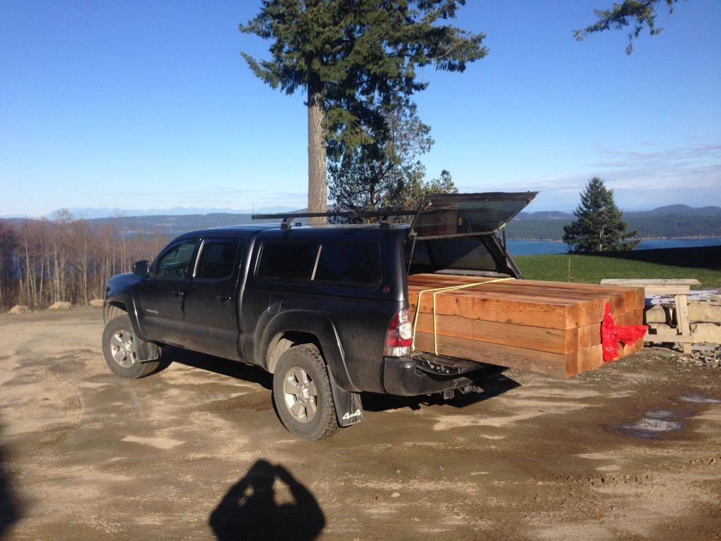

    That is hilarious! I'm not surprised the suspension can take a beating but that poor tailgate. Just enough room to throw a small atv on the lumber.

    It's not touching the tailgate and never did on the drive home

    looks to me like its hitting the tailgate

    This pic is making me reconsider installing my purchase.
    If they are that stiff my rear end is going to be bouncing everywhere in the trails. The shackle flip will help that but still.......

    It's not , I slid the rope in afterwards , they are 10' , 6x6 posts and 6' is in the bed , 4' is out , they aren't even at the tipping point

    They are stiff unloaded , everybody knows that

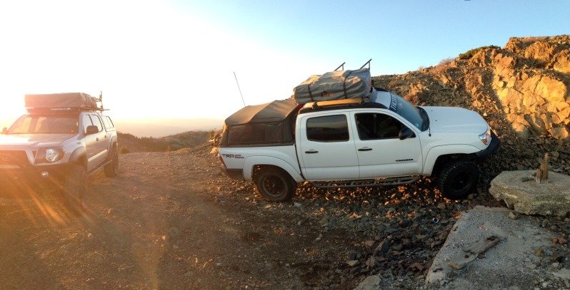

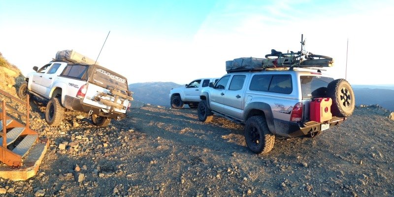

    The dakars are great. Mine hold up a plate bumper, full size spare, gas tank skid, bed rack for spare, a soft top bed cover. Even with a full load of camping gear and bikes there is almost no sag. I have had 1,000 punds of gravel in the bed with very little sag.
    Here is a photo offroading with the bed loaded for a weekend of camping. There is gas and water, camping gear, bikes on the back. three people in the cab, sliders, skids, rear plate bumper. I had no problems offroading and flexing that weekend.
    Flexing a loaded truck at the top of a mountain
