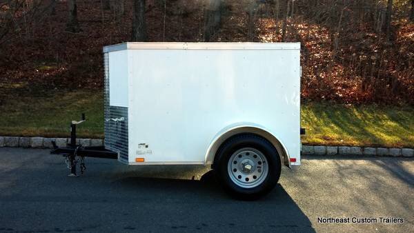

    So, I just ordered one of these little guys:
    4x6 V nose. It comes standard with all tube constructed frame, 16 on center floor and walls, 3/4 plywood floor, 3/8 plywood walls, 3500 lb EZ Lube Dexter axle with 15" tires.
    I added a 12" on center walk on roof, cross bars centered and 3' apart for the RTT, pintle hook in place of the ball, and Charcoal grey exterior.
    The trailer also comes standard with a 4" drop axle. I ordered it with a straight axle for a little more height and to clear 30's

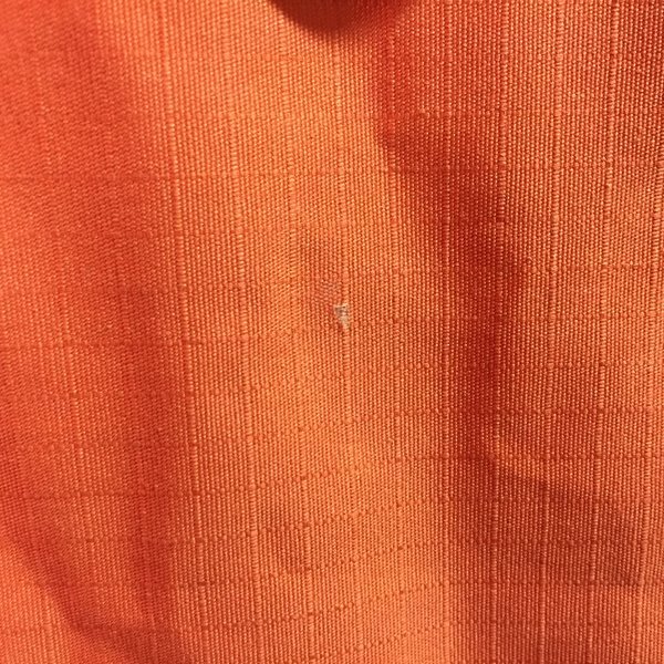

    The tent is here, now just waiting on the trailer to get done so I can start working on that.
    Unfortunetly, it showed up with a small hole by the door. I know I didn't buy it directly from you, but what would you suggest to take care of it?
