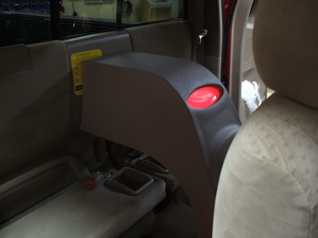

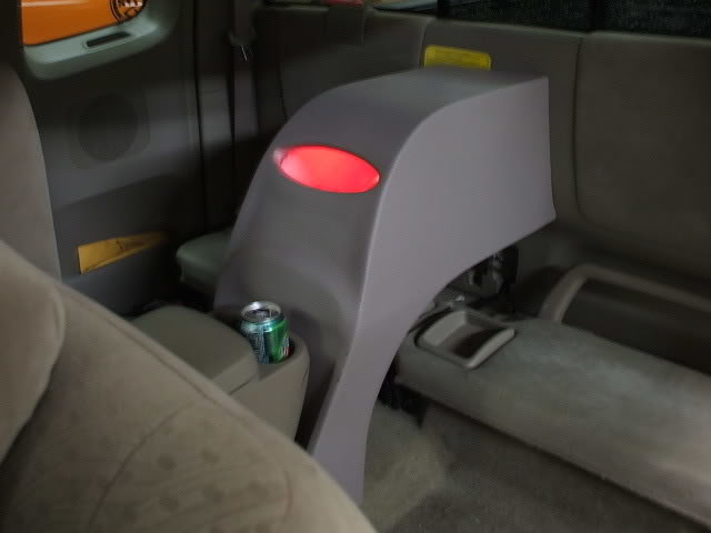

    Pressure only. The rear of the cab, and the cupholder (center console) keep it in place. It was a bastard to slide back in.

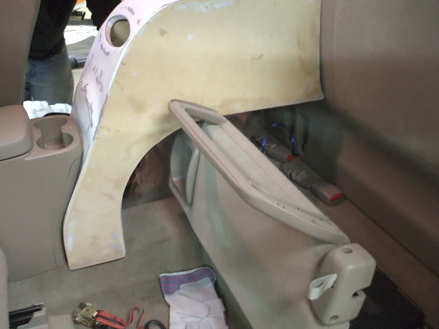

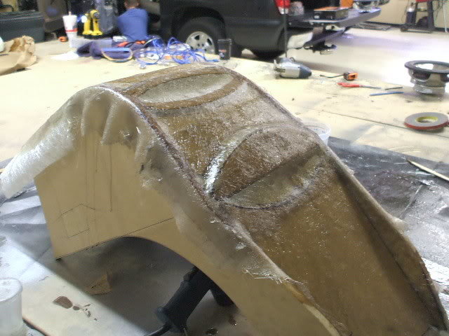

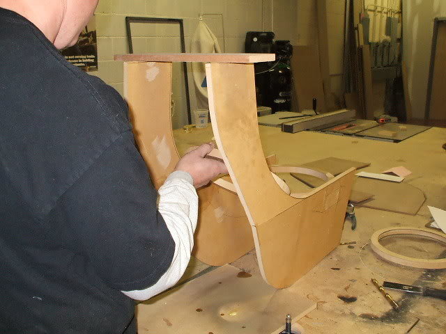

    Thanks everyone. My old boss got me started on that one, and made the side templates for it. Then I finished it out. The customers father owned a bedliner shop, and he used high pressure bed liner, then I color coated it with SEM dye.
