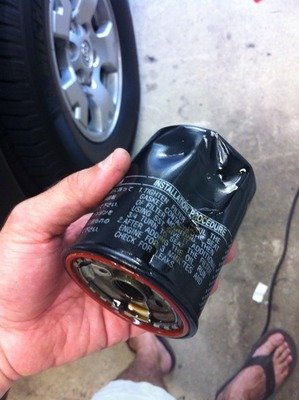

    OP
    you might need both if your truck is brand new. you might need the wrench in post 2 to undo the factory oil filter that was tightened by a gorilla. the wrench in post 7 will then be used on the dealer filters, thereafter.
    i discovered this after i drained all my oil out... i couldnt remove the factory filter until i got the wrench in post 2...

    A trick to remove tight oil filters when you don't have an oil filter wrench available: Using a large slotted screwdriver, stab the old filter completely through from one side to the other on the end furthest from the engine. Then, use the protruding ends of the screwdriver as handles and spin the filter off.

    I just bought the one Larry suggested....the dealer had screwed my filter on incredibly tight, and my trusty strap wrench was too big. Took my longest breaker bar to loosen. I ended up tapping it on the filter for the best grip. Should never ever need it again
