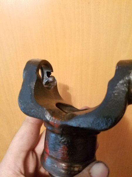

    I think this bad boy is ready for another 50k...what yall think? [​IMG][/URL][/IMG]
    On a serious note, could it last maybe a couple of days without separating...at least till the new one gets here?

    It looks to have a piece missing and is it cracked?
    If so I wouldn't trust it.
    What happened?

    Asking for trouble running that yoke, flailing driveshaft is able to do much damage.

    Sorry it took so long top respond. Off work and I can't resist slapping a new coat of paint on the shaft since it's out.
    I knew that would be the answer but I hate to miss work. Guess it's short trips and talking it easy in 4 Hi this weekend

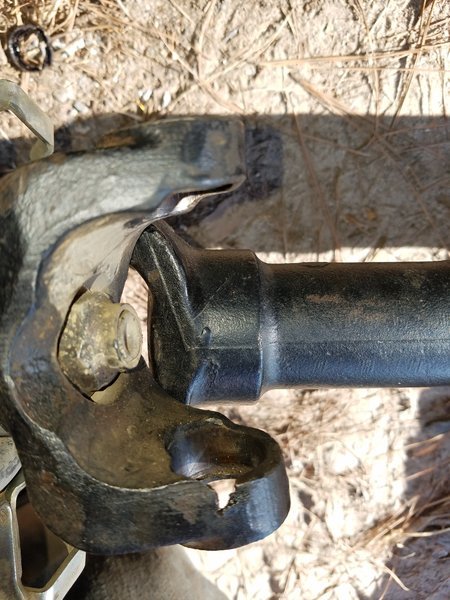

    2 nice chunks missing. One on inside, one on the outside as seen here
    Started getting the u joint takeoff/coast shudder about a week ago and waited too long to fix I'm guessing. Really no telling how long it has been like that...got lucky this time.
