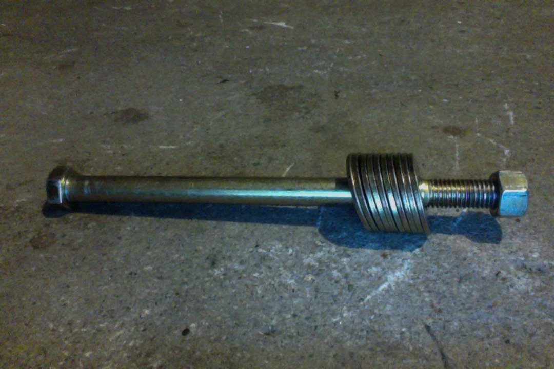

    Made a press with a grade 8 bolt, washers and various attachments form the shop BJ press loaned out from Advance Auto.

    Did you press them in by pushing the rubber with those washers? Or did you press them in using the outer metal ring?

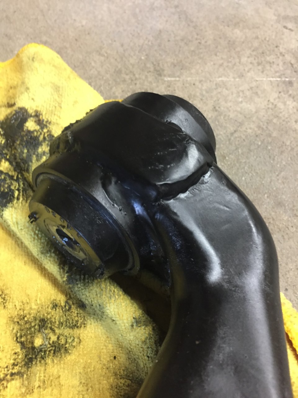

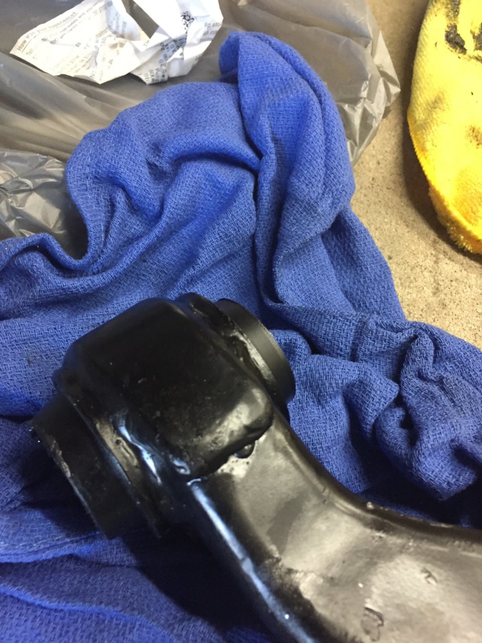

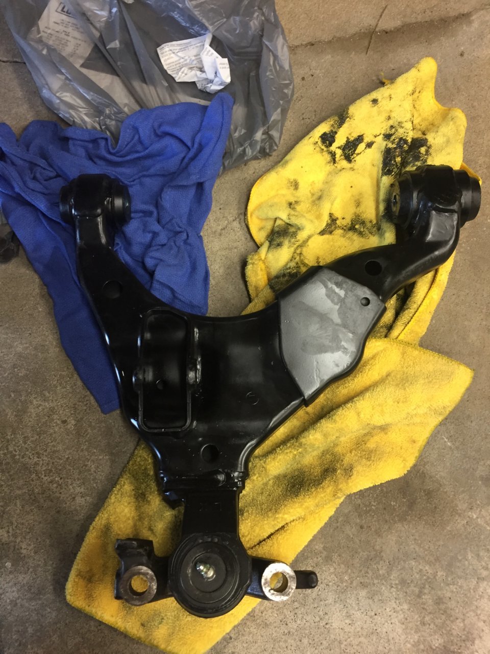

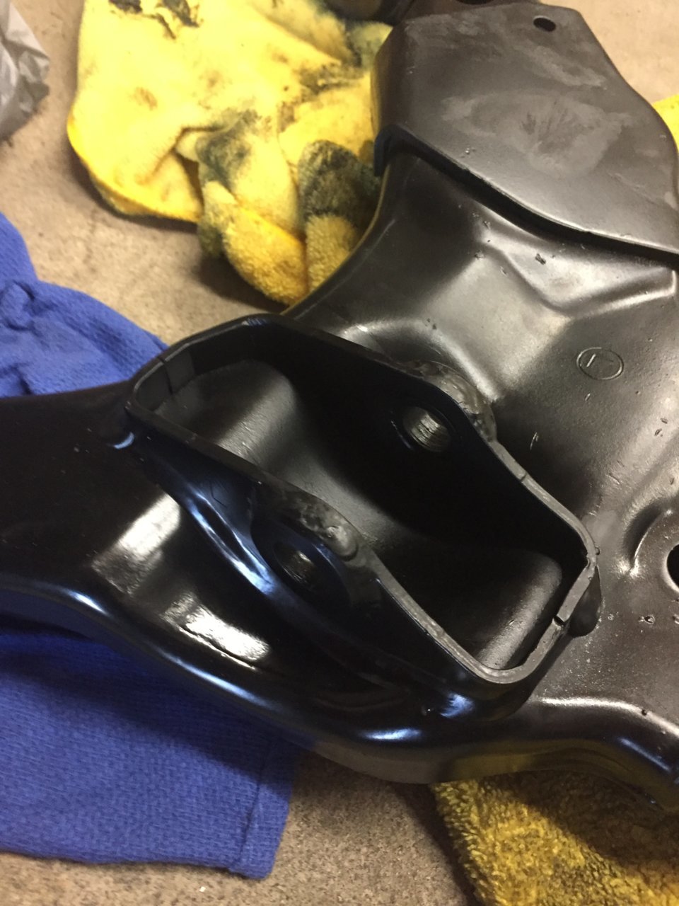

    Upgraded a stock set of LCAs with additional strapping around eyelets, weld washers for shock mount bolts and Whiteline bushings! 9D4F508A-D936-4E4E-AE12-D53CCA3BAC47.jpg1DBB3980-7350-4BFC-B5B4-2C5FBBCE3BB7.jpg9015C168-D062-45DF-ADCE-32A34774D353.jpg6EC30C1C-F373-4415-BCCA-FFB027FE1615.jpg

    I used the cups from a BJ press kit that was borrowed from Advanced Auto. And also a giant socket for the larger bushing.
