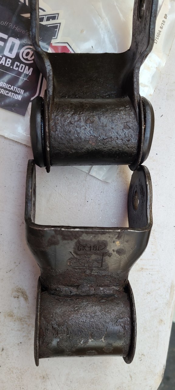

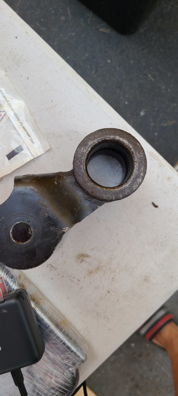

    Unless all the rust and crap made it look like 1 piece. I burnt out the old bushings. Here's a picture of what I have left. 20200922_082449.jpg 20200922_082518.jpg

    Those flanges are the sleeve were talking about.

    Fml well onto finding some bushings as my smart ass pressed 2 in ready and tried to insert the metal socket.

    check these pics from my post

    I see it now, I was probably pissed off by the time I read through this post after spending 2 hrs trying to get that to all workout! Haha
