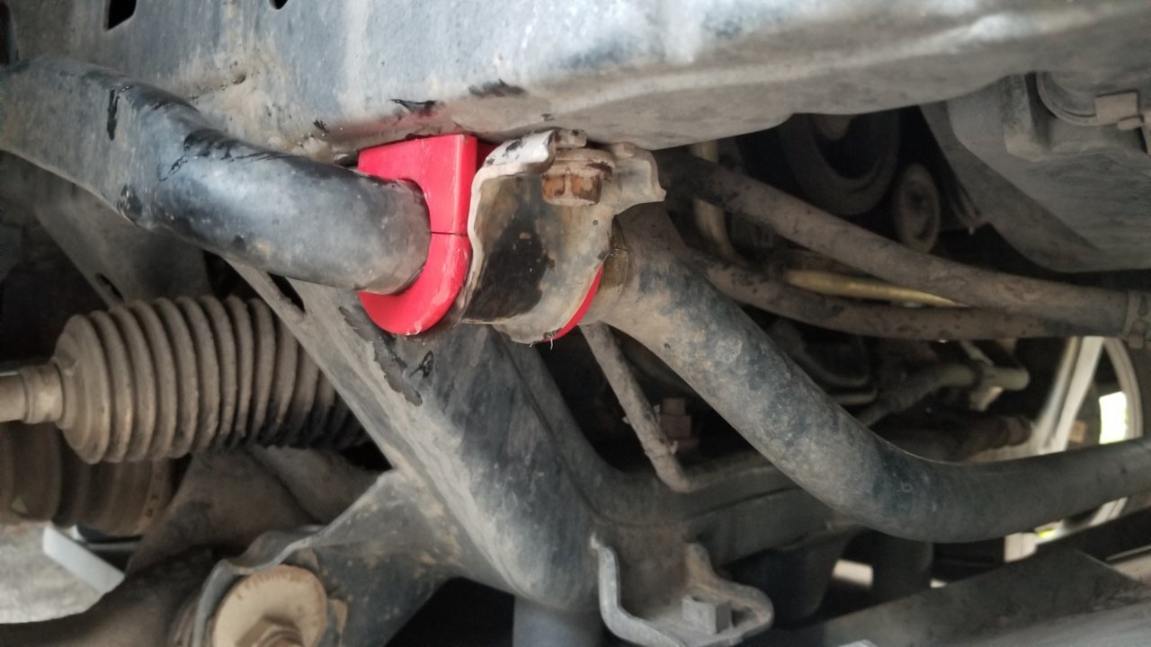

    Anyone using the red ES bushings?
    Got any pics?

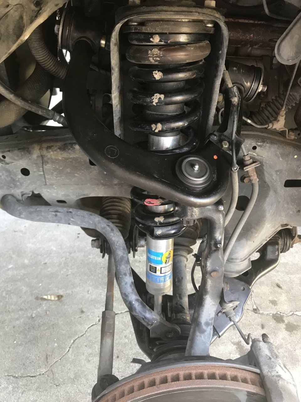

    I installed the black Energy bushings (same hardness as the red but not as flashy) in my stock 2nd gen UCA and LCA. They do ride a bit firmer but that is what I was looking for as well as the longevity. I am very pleased with the results. Read up on their installation as it is a labor intensive operation to do the UCA/LCA's. You need to burn out the old bushings, clean and reuse the stock hardware and reinstall. Not for the feint of heart.
    Energy bushing rebuild.jpg )

    I do a bunch of odd restoration projects so it shouldn't be an issue! But thats what im looking for too, just can't decide on black or red haha
