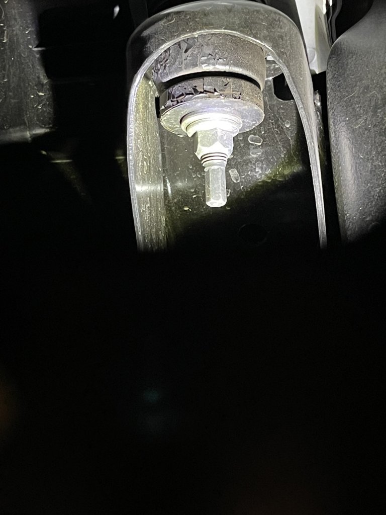

    That surface you see crack might be the flashing from the mold-releasing "compound".

  15. Nov 8, 2024 at 3:41 PM
    #35
    Wesdan13
    Wesdan13 [OP] Active Member
    Sep 27, 2024

  16. Nov 8, 2024 at 5:16 PM

  17. Nov 8, 2024 at 6:05 PM

    23 Tacoma TRD Pro
    Is that amount of play normal though… for the lower one?
  18. Nov 8, 2024 at 6:26 PM
    #38
    tonered
    tonered bartheloni
    Sep 25, 2017
    #231055
    31,260
    tony
    Lynnwood, WA
    Oh yeah. That's all good.
    There's a sleeve on the inside that limits the compression. The rubber just rides on it up and down.

    Mine looked like that as well. Probably just the lower quality rubber

    I just installed my black energy universal ones yesterday. Factory mounts definitely had a hole widdled in the rubber and the sleeve had a couple grooves in it from rubbing on the frame. I installed the big washer on top, big puck with the nipple between the body and frame, nipple side down. Then the small puck on the other end of the mount with small washer. Sound correct?
    I also noticed that the passenger side bushing seemed to compress more than the driver’s side when I torqued them to 30 ft lbs. Not a ton, but I wonder why… maybe the degree of misalignment in the drivers side one had to do with it… Ended up using a box end wrench to pry it so I could get the bolt through the sleeve. Passenger’s side went in like a breeze like most have stated. Had to adjust my little rubber hood stops like a lot of people mentioned as well, though one of them was screwed down a bit more than the other. Seems like it must be normal given the seemingly loosely tolerances body panels/mounts, etc. that a lot of people find on these trucks. I’ll probably just roll with it
