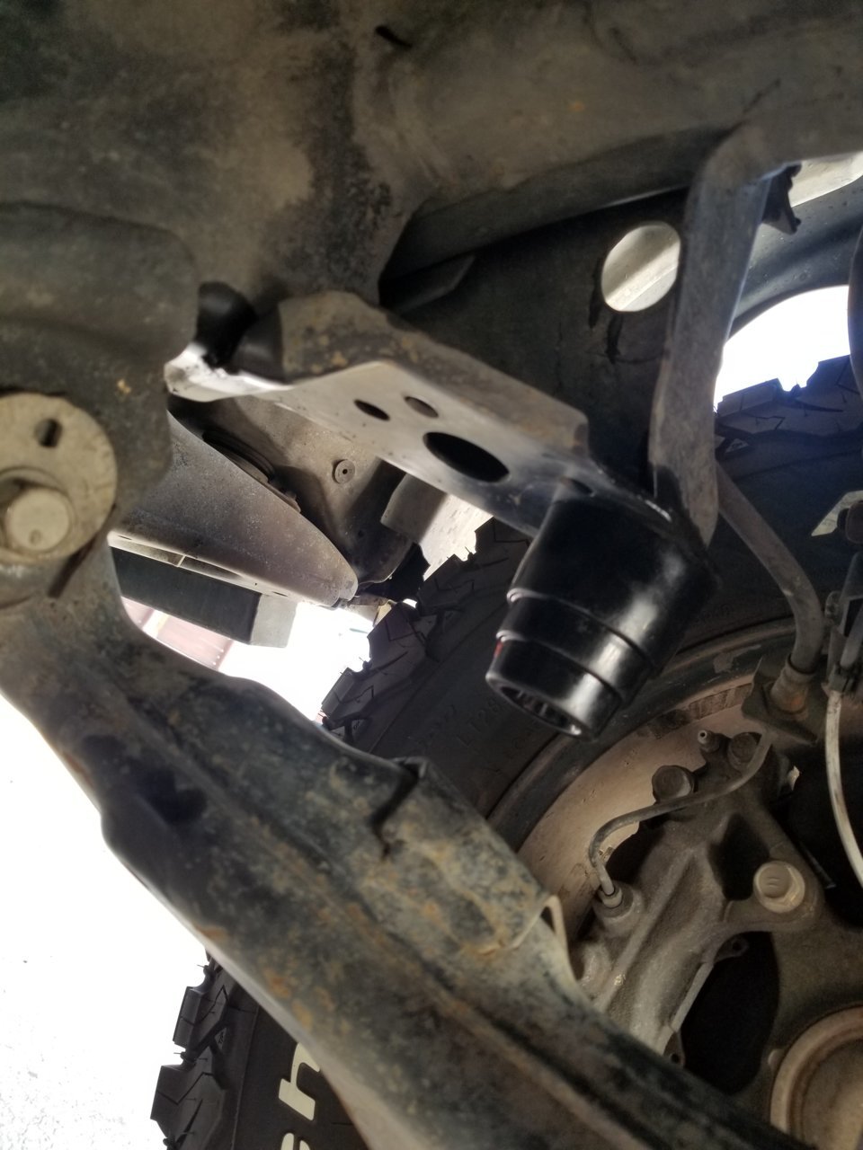

    Just purchased these Energy Suspension bumps for about $30 bucks much much less than other brands out there. They bolt right up and dimensions are fairly close. I went with 2.5 length bumps since my 2010 Tacoma has a 3"lift. I guess time will tell if they are worth it.20211020_161144.jpg
