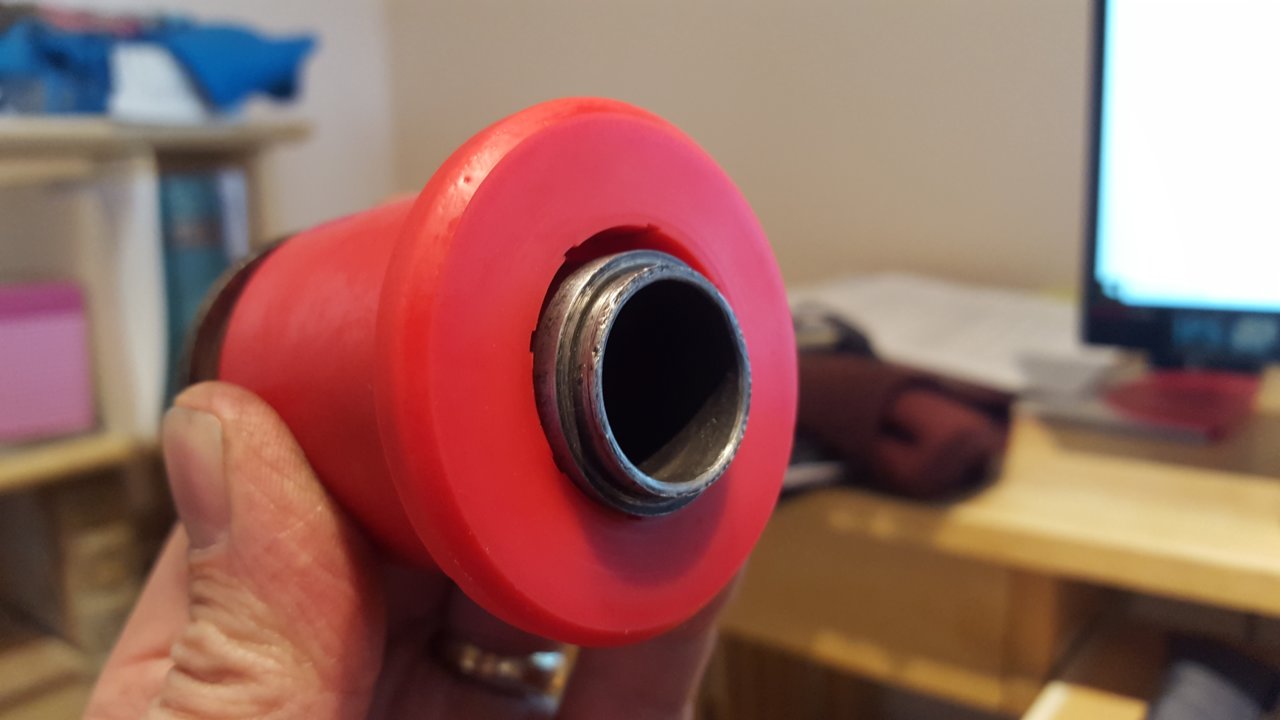

    Hi Folks, new here. I have a 2001 4x4 Tacoma with the 3.6L V6 and 5-speed manual trans. I am attempting to replace my lower control arm bushings with a bushing kit from Energy Suspension. I have removed the old bushings leaving the outer bushing shell per the ES instructions and several YouTube video guides. When I started the process of pressing the inner sleeve into the new ES bushing, I discovered that the sleeve OD is maybe two millimeters too small. The inner sleeve just rattles around inside the ES bushing.
    I recon the inner sleeve is from some after market bushing set from long ago and that the inner sleeve is not OEM diameter. My question is, where can I find an OEM inner sleeve? I am aware of the Whiteline bushings that come complete. I understand Toyota also sells the bushings complete. Since my outer bushing shells are still in my LCA, I can't use either the Whiteline or OEM bushing. I need a source for the OEM inner sleeve to make the Energy Suspension kit work. Any help greatly appreciated.

    Thanks guys. I thought about the possibility that the bushing might fit the sleeve once pressed into place but looking at videos of people using the same kit, their sleeves fit tightly in the bushing before they put them into the control arm. So I'm pretty sure it's just a mismatch. At this point, I'm resigned to buying new control arms with the bushings already installed.

    I wasnt aware that there are different sized bushings, and im not convinced that there are, I really think you were given the wrong bushings.

    That's entirely possible. The label on the package matches up with energy Suspensions part number for my truck but they don't fit!

    If the bushings you are using are not OEM they have a smaller inner sleeve than OEM. I ran in to this problem myself as I figured I would buy some cheap aftermarket bushings to burn out and use their sleeves. The inner sleeves were smaller.

    The above is correct. Also possible that ES gave you the wrong bushings in the right box.
    Measure what you got against this.
    OE inner sleeve OD is 1 9/64" or 1.14" or 29.1mm depending on your preferred unit/means of measuring.

    You have some aftermarket sleeve. It isn't ES's fault that someone down the line changed the bushing out.... Most people I have seen swap bushing have't had that issue. The situation sucks but its not an ES issue.

    I'm nearly 100% positive there is no variation in the 1st gen 6-lug control arm bushings. They're all the same. They're probably even the same for the 2nd and 3rd gens, too.
    Either ES gave you the wrong kit, or you already had aftermarket bushings in your vehicle, for which of course it's possible that the ES bushings wouldn't fit the inner sleeve. That's not ES's fault.
    My ES bushings fit perfectly.
