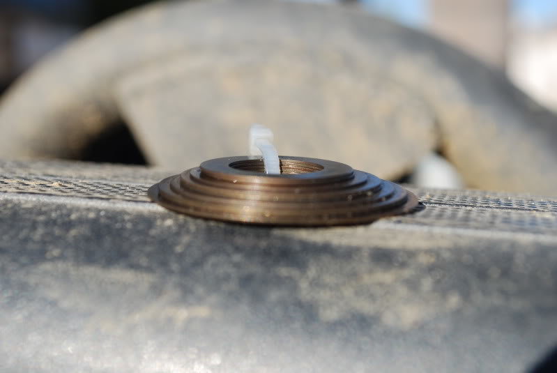

    tuning is all in the shims you use. The thicker the shim on the compression side of the piston the stiffer the shock will be, thicker the shims on rebound side of the piston the slower your suspension will drop out and vice versa. Its a little more complicated than that cause there are different variations of shim stacks you can use, flutter stacks, rate plates ect... but its pretty basic. Then you can fine tune with bypasses via the rebound and compression tubes.
    heres an example of the shims im talking about

    Damn! Thanks for the great write-up. It's how I learn. That sounds a little complicated :eek: Maybe after you've been doing it for long enough, it comes as second nature. So when you talk about "sides of the piston" are you talking about inside the shock body itself at each end? Sorry- I'm very new to the insides of shocks (never peaked inside one.) heh. where are the diagrams when ya need one :p

    heres a very basic picture of the shaft and piston. the compression side of the piston facing down towards the shaft, and rebound side is facing up, think about which way the shaft is moving on compression and rebound then you will figure out why x valving goes there.
