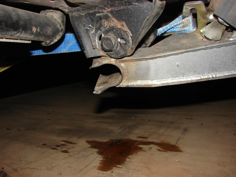

    so on saturday my lower arm broke off right at the pivot point on the front of the lower right side A arm was going through a wash and with no warnings lower a arm came off from the front to back but my front mount is completly fine showing no damage look at the pics, so my question is whats every ones opion on this i think that if i would have hit something that hard i think that the front stock mount would have bent or tore off first like the rear did please help i think the ENGAGE should fix at there cost.........

    looks like it broke right at the welds to me!

    Doesn't appear to be at the welds. It appears to be at the seam of the tube which the bushing is pushed into, (seamless tubing should be being used, not sure if it is or not)

    That piece (gusset) on top that is welded (seen in 3rd pic) should wrap all the way around the bushing mount to bottom of the arm if they are using seamed tubing...might be something to do either way since this isn't the 1st occurrence.:cool:

    you got what you paid for , unfortunately. but they should take care of you , it should have never happened. dont know how they are gonna repair the piece of frame that was ripped out without you being local either
    even if it was seamed tube and the seam was welded in the right position it might happen. thats why you never use .120wall tube for control arm pivot points! .1875 at the minimum and .250 for race applications.
