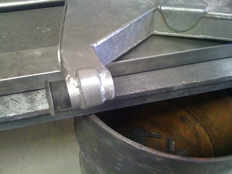

    can you get a thickness measurement on the bushing sleeve so we all know how thick(or thin) it is?

    looks thick. hopefully that will bring peice of mind and no chances of failure.

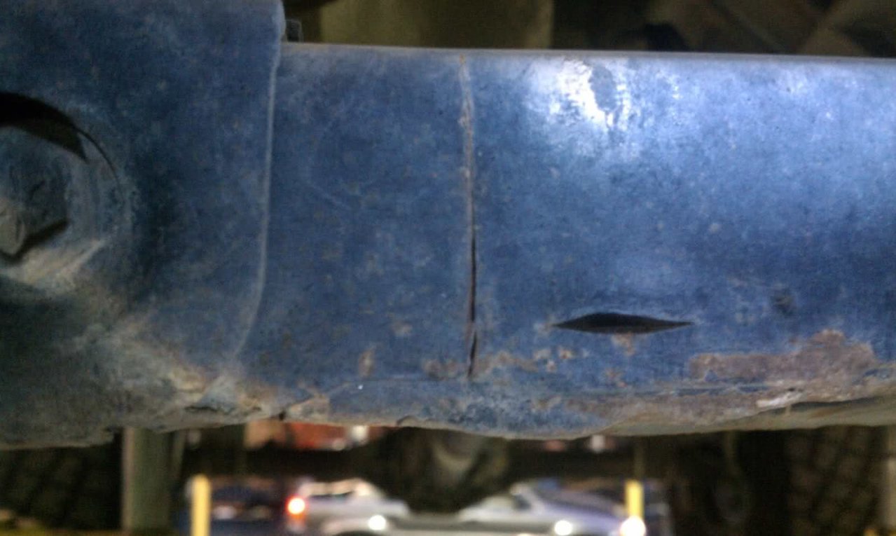

    sidenote: found 3 nice size cracks in my cross member today

    to be clear, we worked on the truck since 830 am today just not up to taking the LCAs off for a measurement

    What kind of material was used for the strap? Looks thick!

    Pics? Which xmember?

    I hate to say this but two on either end (or one the whole width) would have served you better. The ends are the place that the cracks start and then they propagate to the center.
    Looks nice otherwise.

    Man glad my kit has .250 wall at the bushing collars.

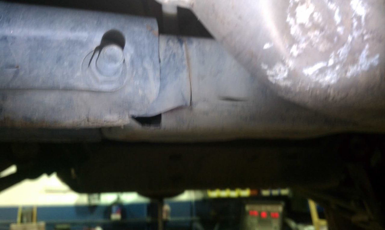

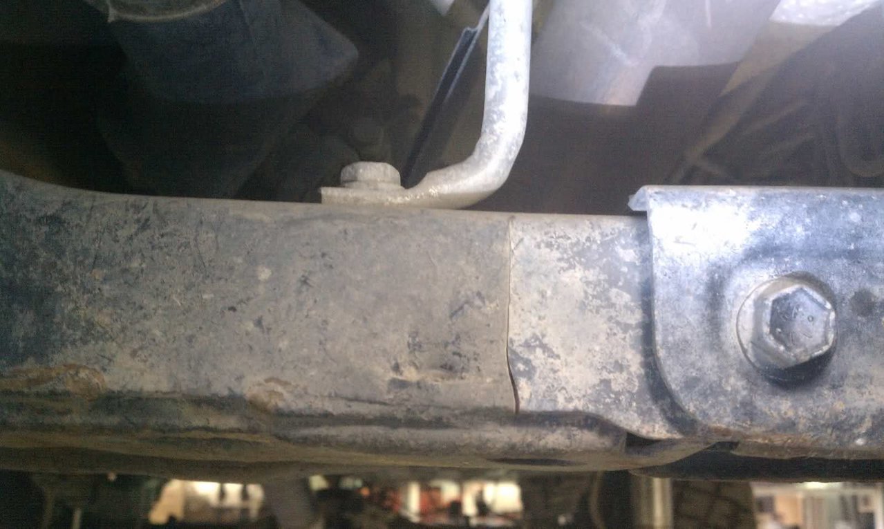

    main xmember for the tans/tcase:eek:
    driver side..facing front
    driver side..facing towards rear
    passenger side, facing towards rear..

    I know you know this but I would drill holes on the end of each of those to stop them from going any further. Time to slap a crawler box in that bitch!!! :)

    im ordering a new one in the morning and then going to figure out a way to reinforce it before i slap that bitch on. i think that's the best option right now..easier then fabbing up something completely new

    Yeah, I have some cracks starting there but not that bad. I know I need to do something but I would love to flatbelly if I mess with it!! :)

    i have the same exact cracks that monkeyproof posted lol guess it a high stress area. i plan on doing the same also, order a new one and just reinforce the shit out of it lol
