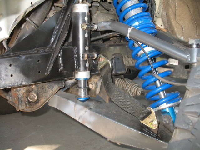

    yep same here. after looking at the picture of Blackhawk88 the sleeve does look pretty thin. you can tell cause the bushings is in it and od of the sleeve is barely there most likely .120 wall at most and as for material used I'd say mild steel

    My own opinion is that the bumps were not set up correctly on either engage kit that failed. When the LCA was at full stuff and bind the energy has to go somewhere, and there is a lot of leverage focused on those LCA pivots. Obviously quality 4130 material, or .250 USA DOM material and gussets would have prolonged the inevitable but without bumps taking some of that energy away it would still happen eventually. These frames flex far more than most guys think. I noticed my TC arms wear the powdercoating off on that same part of the inside of the pivot, indicating it is a high friction area. Wear from not lubing the bushings enough could also be a contributing factor.
    Oh and monkeyproof, cut that xmember in half and sleeve it with some DOM tubing, that's what I ended up doing and it's held up great.

    This is how mine is set up with JD, all I get is a smashed in bump pad and dented LCA, but with this kit, there isn't much room to deal with it. It's been like this for a long time now too. I could mount it off the UCA spindle bolt but it's really not worth it with a kit like this.

    I just want to say that I am using the same exact pivots on the PLOW for the last 7 years. It has probably seen more race miles and offroad miles then most or all trucks that will ever leave the shop. My front pivots have never had an issue and have alot more leverage on them as my arms are much longer. Also there is not one race or offroad session that my suspension has ever failed. Only things that have gotten us at races are tires, rear leaf springs, fuel issues, wiring issues. We have finished 9 of our 11 races in the plow and the two DNF was fuel and wiring issue, and leaf spring issues.
    We race several trucks with the same kits and same pivots. There is not any harder abuse then racing on the trucks period. They have raced baja, preran baja, raced barstow, placed 2nd in 250 mile race in baja. Engage is not a new shop and has now been around for more then 10 years. We dont in any way use great material on all of our own trucks and then go cheap on customers trucks. We use the same strong metal on all kits since the beginning..

    Once again this can go on forever but if you look at most failures you will see rust. There is no way the leaf hanger and front pivot rusted instantly when they broke. That means either a crack or tear was there for an undefined amount of time. Yes tears or cracks will break eventually. But if prepped correctly before each trip then this can be patched up before hand. This could have happened several trips ago for either truck and the failure happened at that time. Who can say otherwise. There is no seam placed outside on the pivot. So it is not a seam that just popped open.
