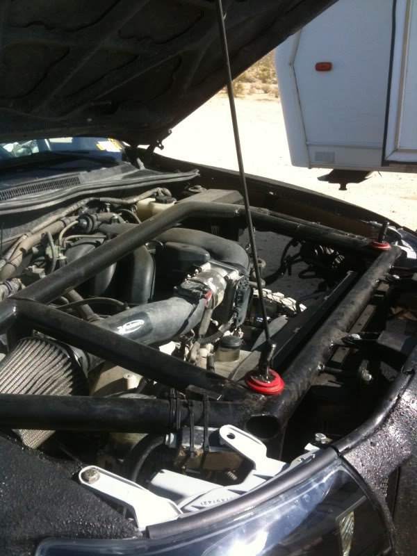

    Think lower contol arm bosses - we all need engine cages! :)

  17. Mar 7, 2012 at 9:48 AM
    #337
    mikesdoublecab
    mikesdoublecab LT Chase Truck
    Jun 15, 2008
    #7334
    7,243
    Mohawk Mike
    Glendale, CA
    01 Tacoma DoubleCab V6 Prerunner
    Engage Offroad long travel front and rear with some fat tires.
    my coil buckets are gusseted and have the secondary shock hoops on top of that, and the energy went straight into the frame...
    we recently repaired 6 inches of torn front frame and another driver side motor mount...
    i should have reinforced the frame and stock motor mounts back when i gusseted the spindle and coil buckets... i may eventually have to cage it...
  18. Mar 8, 2012 at 6:39 AM
    #338
    username
    username Fluffer
    Oct 15, 2010
    #44704
    6,064
    Pendleton, Or
    05 Taco with some crap welded to it
    mostly stock
    No maybe about it homeskillet. I haven't torn or broke anything frame related since the cage. I also took a chunk of 1 3/4" moly and slid it into the end of the frame rail from the front of the truck, and beat it in as far as it would go with a 5 lb sledge. I got about 5' of tubing in, then welded it to the frame anywhere that I could see it through holes.
